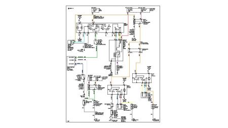

blower runs cont. ign. on or off. must dis.motor terminal to shut off. also no speed controlsfrom inside

I would check for after market wiring
check relay
check wiring
Mar 9, 2008 at 11:00 AM
  • 75,992 POSTS
Get the HVAC Control Module tested out this is where I forsee the problem. Is it the front blower only? see below
