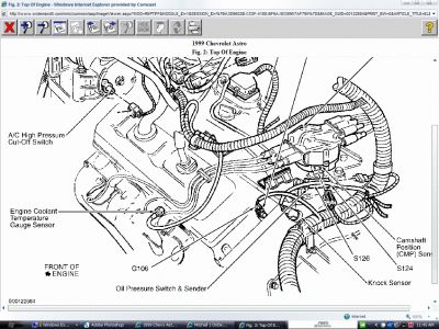

There doesn't seem to be power going to the fuel pump relay. I have no blown fuses, not sure where to go from there

check the oil pressure switch as shown...
https://images.2carpros.com/forum/automotive_pictures/62217_OPS_2.jpg
