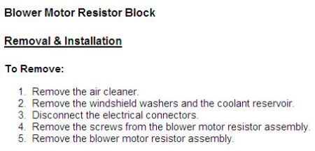

I have a Chevy Astro van 1999. Typically in the hot summer in FL my high speed fan and ac stops working. This has happened previously. Each time the repair service replaces the ac blower resistor. Since this appears to be happening routinely and the fix is always the same has a design issue been identified by Chevy. Has Chevy corrected this and how and what does it involve to fix the problem. Is this a fix I can do myself if I buy the part. Thanks for your assistance.
Sep 5, 2019 at 3:20 PM (Merged)
JDL
  • 16,098 POSTS
You said high blower speed? Do the lower speeds work?
https://images.2carpros.com/forum/automotive_pictures/170934_chevy_astro_resistor_1.jpg
If the problem is the resistor for the front blower, I don't know why you can't replace it yourself?

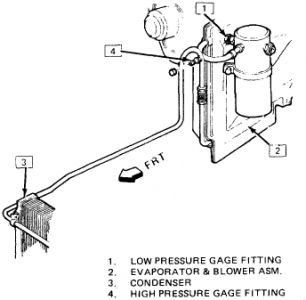

Air Conditioning problem
1997 Chevy Astro 6 cyl Two Wheel Drive Automatic
how to refill air conditioner cooler on a astro van
Sep 5, 2019 at 3:21 PM (Merged)
  • 75,992 POSTS
Charge it @ the low pressure valve-see location below: Service Port HVAC Figure 1 B-5 Low and High Pressure Gage Fittings
https://images.2carpros.com/forum/automotive_pictures/12900_sp1_5.jpg
https://www.2carpros.com/kpages/auto_repair_manuals_alldata.htm
