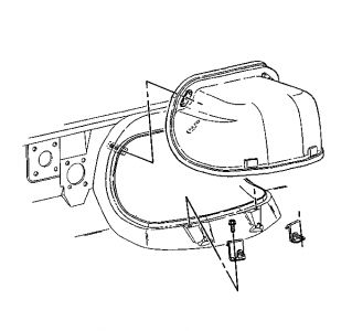

Hi there i was wondering how i get at the o2 sensors on bank 1 sensors 1 and 2, are they on the backside of the exhaust manifolds, an also do i have to take the dog house out to do it i have never had one apart, i am a new owner of an astro van and am not looking forward to working on it but can not afford to hire someone to fix it, i am very handy when it comes to working on cars but this van is deffinetly a horse of another colos please any information you cn give me would be a great big helpm thanks alot and look forward to hearing from you.

take the instrument panel off,and then the dog house.both 02 sensors should be wright there.the dog house bolts are 15mm.
https://images.2carpros.com/forum/automotive_pictures/147643_cover_1.jpg
post back with any other questions.
