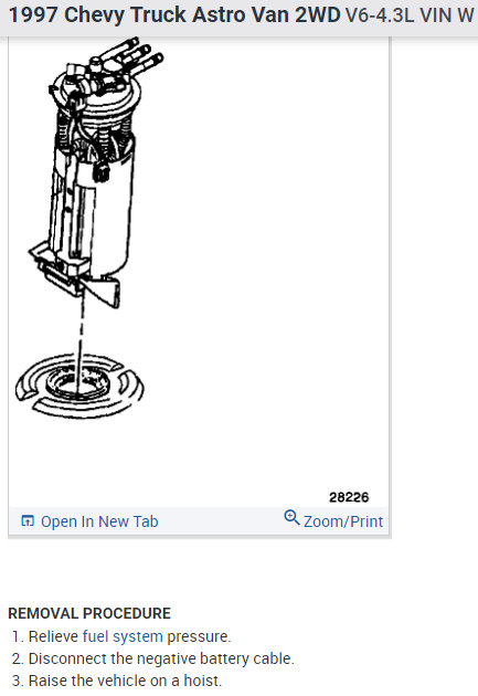

Fuel pump went out on our van, replaced with a used one because of the high cost of a new one. It works but the gas gauge reads as full always. I have run out of gas several times because of not knowing how much gas I have. Can it be fixed without having to buy the full price of 300.00 for a new one?

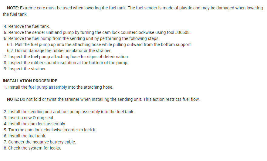

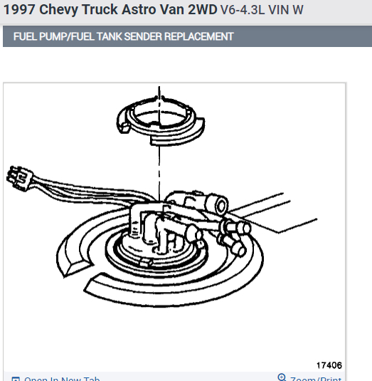

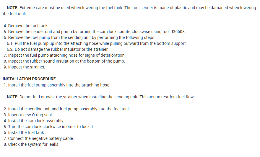

It sounds like the sending unit on the replacement pump is faulty.
https://www.2carpros.com/articles/how-to-replace-an-electric-fuel-pump
See attached for the sending unit replacement procedure.
Let me know if you have any questions.
