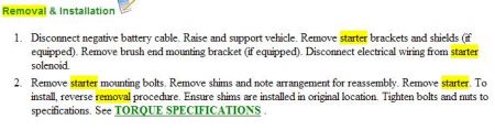

I am trying to replace my engine starter where is the easiest approach to remove and replace the starter?

Hi there, Starter motor removal information. Mark (mhpautos)
https://images.2carpros.com/forum/automotive_pictures/61395_Noname_33.jpg
