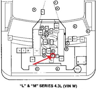

Where exactly is the throttle position sensor located in a 1995 astro
Jun 25, 2010 at 3:39 AM
BLUELIGHTNIN6
  • 16,542 POSTS
on the throttle body assembly itself..pic below

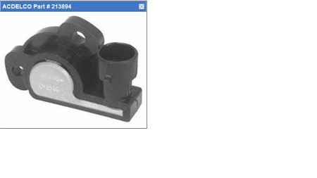

Located on the throttle-body assembly, throttle shaft. It should look similar to the picture. Three wire connector, gray--black--dark blue.
