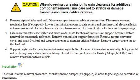

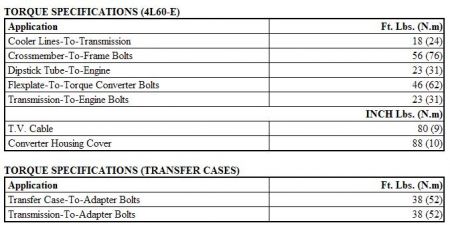

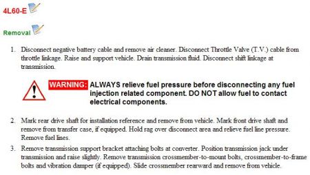

1995 Chevy Astro procedure for transmission removal
1995 CHEVROLET ASTRO
BOBARINO
Transmission problem
1995 Chevy Astro 6 cyl Two Wheel Drive Automatic
what is the process for taking out transmission on 95 astro van

Sep 7, 2009 at 3:35 AM
