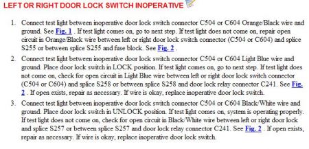

my power door locks work fine from driver side or from the viper alarm remotes but only works to lock door from passenger side door switch please help
Jan 7, 2009 at 8:30 AM
BLUELIGHTNIN6
  • CAR REPAIR CONTRIBUTOR
  • 16,542 POSTS

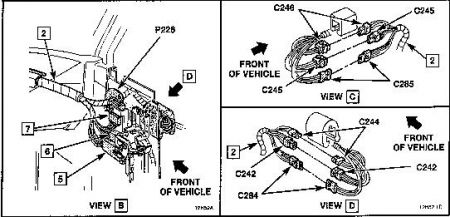

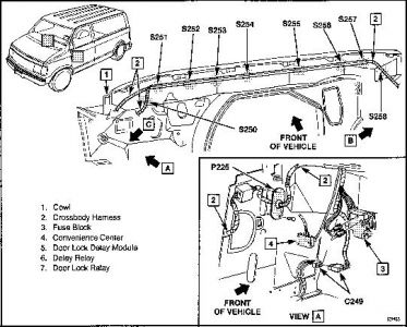

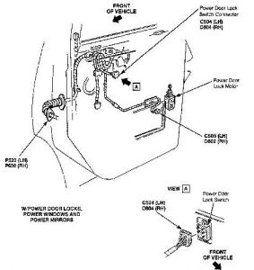

Hello Thanks for the donation. Sounds like your passenger side door lock switch is faulty. You can perform the follow tests to rule out any wiring issues.
https://images.2carpros.com/forum/automotive_pictures/261618_Noname_92.jpg
FIGURE 1
https://images.2carpros.com/forum/automotive_pictures/261618_fig1_3.jpg
FIGURE 2
https://images.2carpros.com/forum/automotive_pictures/261618_fig2_3.jpg
https://images.2carpros.com/forum/automotive_pictures/261618_figure22_1.jpg
If you would like an estimate on having this component replaced at a repair shop just let me know. Or if you would like to save some green and replace the part yourself I can post some removal/installation instructions. Post the results of the wiring tests and let me know if you need anything else. Hope this helps.. Thanks for using 2carpros.com!
