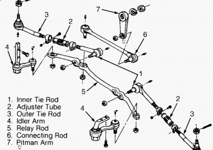

hey fellas I have a 1995 chevy astro van and my pitman arm broke off the frame I had it wielded back to the frame today but 30 mins. after I drove it from the wielding shop it broke back off I want to know if it can be repaired or is it a lost cost and if it can be repaired about how much it would cost

You sure it wasnt one of the idler arms? Pitman is on the end of the steering box, cannot weld it to the frame, or you wont be able to steer!, Buy a new idler, it comes with the new attaching arm!
https://images.2carpros.com/forum/automotive_pictures/62217_astro_1.jpg
