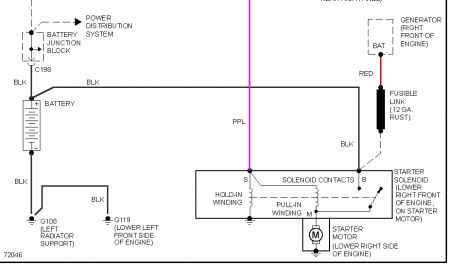

I had a problem with the van not starting when you turn the key nothing happened (click). Checked battery it was good. Replaced the starter and was working fine(about 1 month)then all the sudden I am having the same problem. I kept playing, turning the key and eventually it did start but then after starting the van about 15 times the problem happenend again.
Monday, November 8th, 2010 AT 9:36 AM
3 Replies
JDL
  • 16,098 POSTS
The purple wire at the starter solenoid S terminal should be hot with key in the crank position, is it? If not, backtrack the circuit, my info shows that voltage comes from ignition switch.
https://www.2carpros.com/forum/automotive_pictures/170934_astro_starter_circuit_1.jpg

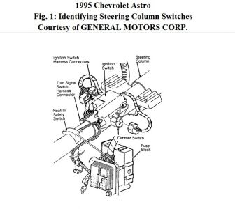

RICK5539
The ignition switch you are refering to is that the one that is strapped to the column down by the brake or the ignition key switch?
+1
Monday, November 8th, 2010 AT 10:40 AM
JDL
  • 16,098 POSTS
My info shows this for ignition switch location.
https://www.2carpros.com/forum/automotive_pictures/170934_astro_ignition_switch_1.jpg
