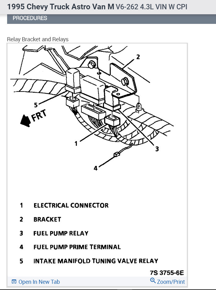

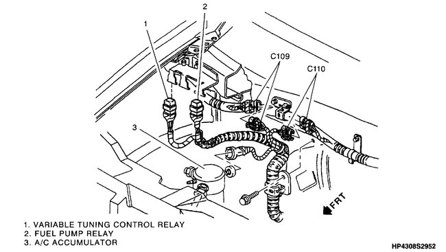

Where is the fuel pump relay located at?
Friday, January 8th, 2010 AT 12:15 PM
JDL
MECHANIC
16,098 POSTS
Here is a guide to help you test the relay with the fuel pump relay location in the diagrams below.
