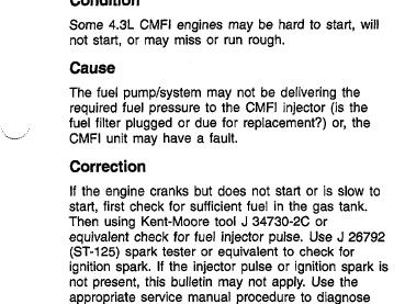

i hav a 95 chevy astro the motor turns but will not start checked fuel pump good ignition coil good firing fine but wont staart some one please help im gettin spark at the coil ican hear the fuel pump when i turn key on i was drivin it spudard and cut off wont start with starting fluid
updated 11-13-09
i have checked its sparking at the coil whats the deal with the fuel system

welcome to the forum, engine cranking, did you visually check for spark at the plugs? Use a gage and check fuel pressure. You have that spider fuel system? I've seen bulletins about the poppets sticking.

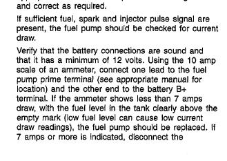

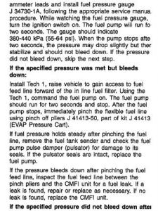

That is part of bulletin 56-63-06
