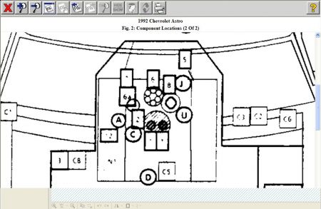

Our oil pressure gauge shows the pressure is low. We have purchased a switch interruptor, but can not find where to replace it. Can you send us a diagram of the motor showing where it goes?

Its on top rear of engine see location no.8 below same as Vortec W
https://images.2carpros.com/forum/automotive_pictures/12900_opsu_8.jpg
