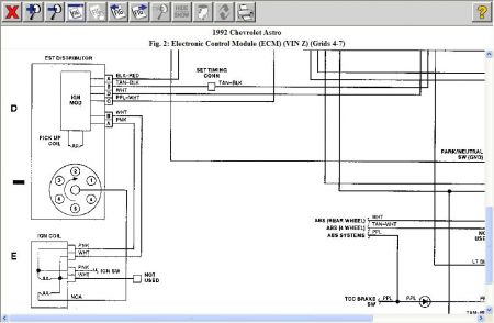

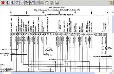

GARYHUFF
Thanks for the speedy reply. I have high voltage so there has to be a tach signal. If this alone provides Injector timing signal through the VCM then Injectors should fire if they are Hot and the vcm sinks them to ground. I assume I should probe that tack signal at the ECM but haynes does not show anything other than a tach test lead at the ignition coil. This is a 16151111 vcm
any help
Monday, January 26th, 2009 AT 6:29 PM
KHLOW2008
  • 41,814 POSTS
The tachometer receives its signal from the ignition coil.
The ECM receives its signal from the distributor ICM. ( PURPLE/WHITE wire in diagram ) Injectors are grounded from signals from the distributor and you should test ECM terminal B5 for distributor pulse input.
https://www.2carpros.com/forum/automotive_pictures/192750_ECM92Astro01_1.jpg
https://www.2carpros.com/forum/automotive_pictures/192750_ECM92Astro01a_1.jpg
