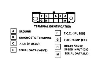

Did you try checking for codes? You place a jumper wire between A & B terminals of datalink connector, then turn the key till dash lites come on, no further. The mil starts flashing, you count the lashes to get the codes. Your looking for two digit codes. The picture below is generic GM obd1 datalink connector, just to show location of terminals A & B.
https://www.2carpros.com/forum/automotive_pictures/170934_obd_1_datalink_connector_3.jpg
