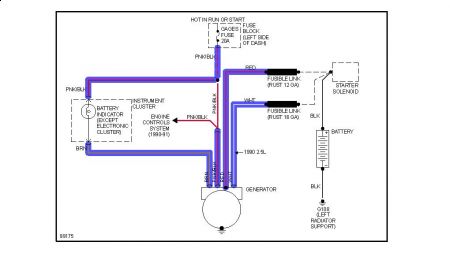

i just got the van off a family member he told me that he replaced the alternator but the battery still don't hold a charge can the new alternator be bad or can it be some thing else ,,,, the batter it has is new i put that in

Hi luish75, Welcome to 2carpros and TY for the donation Could be a defective new alternator get it load tested if okay check and test wiring/fusible links/fuse gages 20amp-See below Charge system EWD.
https://images.2carpros.com/forum/automotive_pictures/12900_charge_9.jpg
