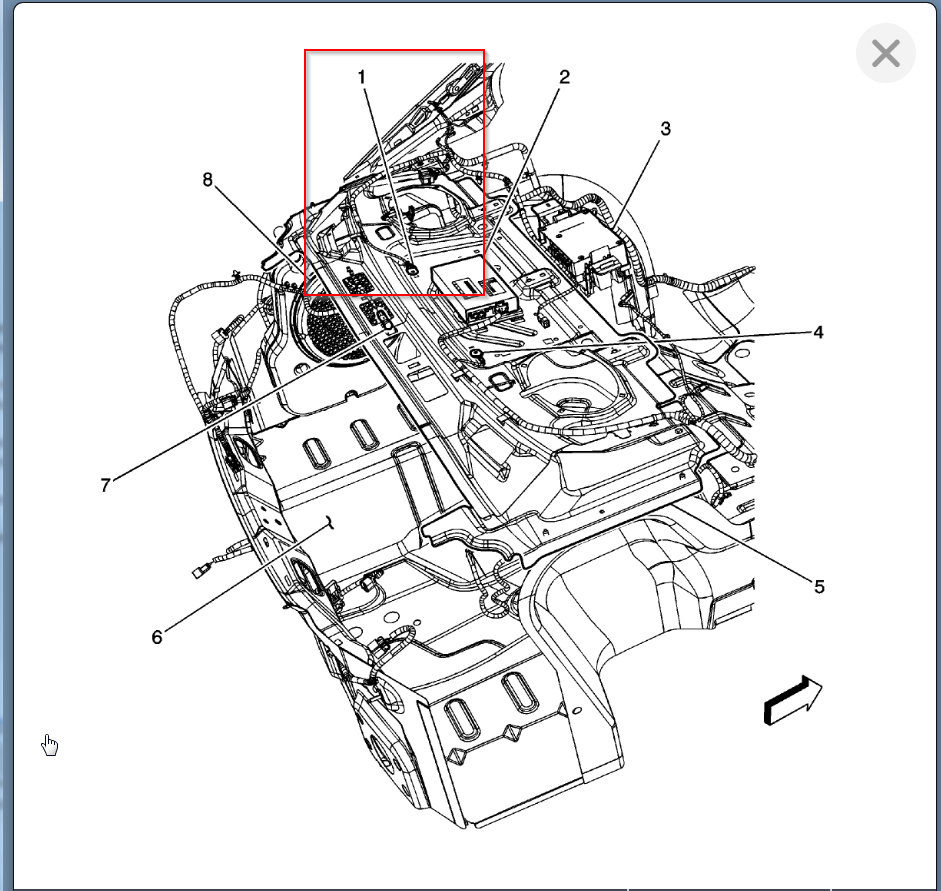

where is the ground for the cargo or trunk light in the car listed above?
Mar 24, 2020 at 3:16 AM

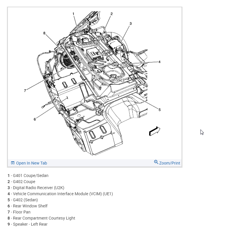

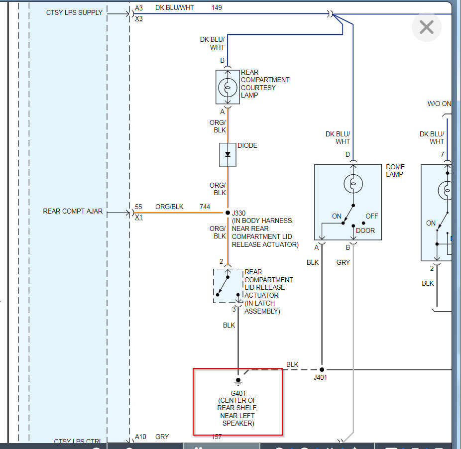

It appears this is G401. Take a look at the attachments for the detail. Let me know if you need more info. Check out the diagrams (Below). Please let us know if you need anything else to get the problem fixed. Thanks
