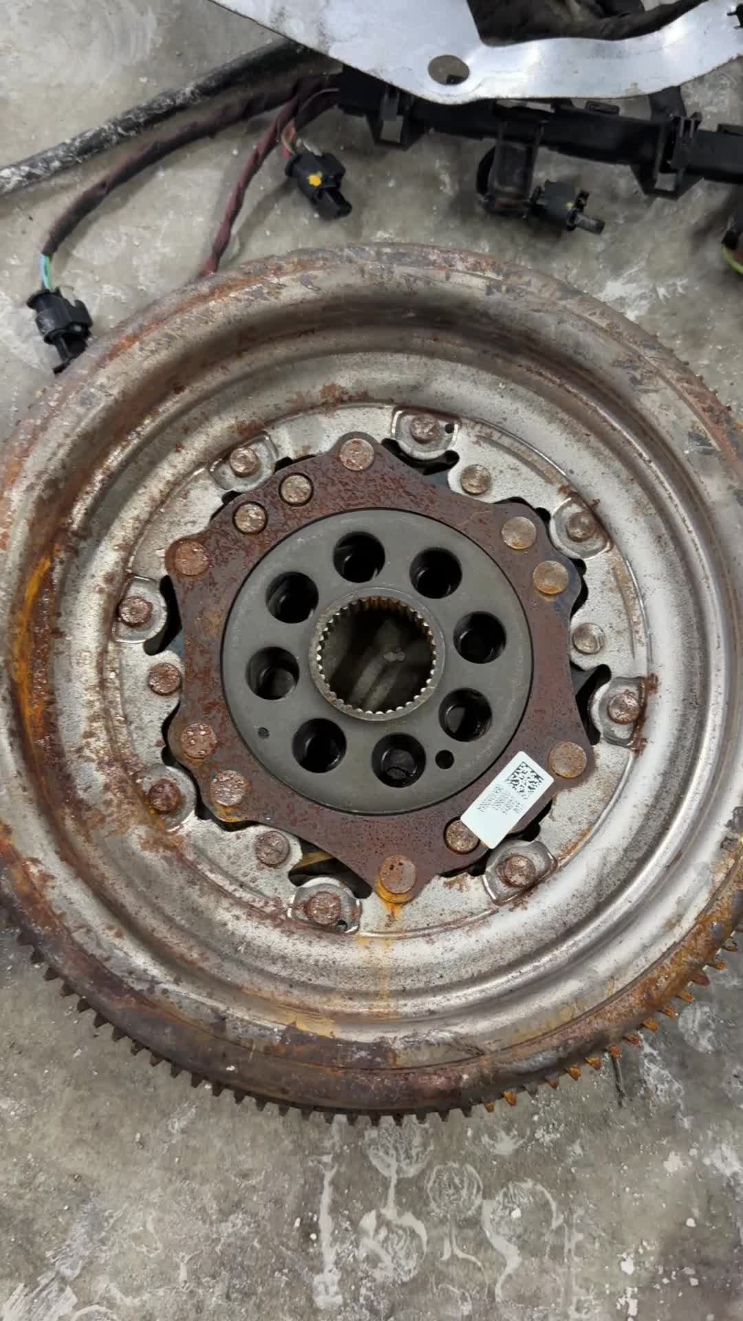

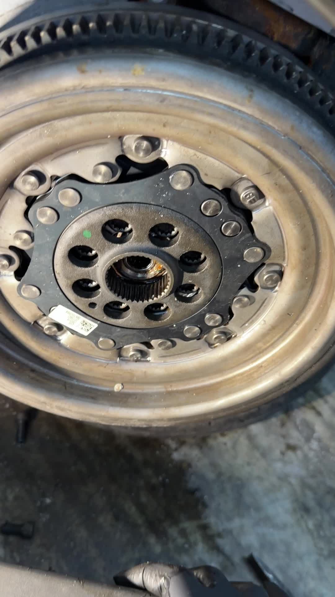

Checking the dual mass flywheel?
2016 AUDI A3
92,000 MILES • TURBO • 4WD • AUTOMATIC
BHAMDOC1
  • 351 POSTS
While replacing the motor i had to swap the flywheel. I didnt have any issues with the transmission, but wanted to double check. You ever had to check these for play? I read online that there is a decent amount of play that is ok or normal. Can't really tell but they both pretty much the same.

Yes, some play in the dual-mass flywheel on these is completely normal, so I would not condemn it just because you can rotate the two sections relative to each other. I would use the unit that has less miles on it though. Thanks for the videos.
