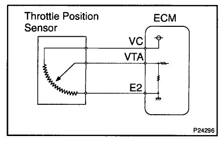

This guy on YouTube was able to check his TPS sensor, but I cannot figure out what pins he is checking.

Will this work on a 3 pin sensor and how can I tell which pin is which?
Which settings on the dial should this be checked with?

A TPS is a variable resistor. Inside it has a wiper that rubs across a resistor. The three pins are easy The center is the wiper and is the signal to the ECM.
Two ways to test them.
First is while they are plugged in, You use a voltmeter set to volts DC. Then you probe into the back of the connector and measure the voltage that comes off the center pin. The voltage should be around .5 volt and rise to around 4-4.5 volts. The big thing is does the voltage rise smoothly and not drop out as you open the throttle.
The other way is to unplug the sensor. Then set the meter to ohms. Touch one probe to the center pin and the other to either outer pin. When you move the throttle the resistance will either rise or lower depending on which end pin you connected to.

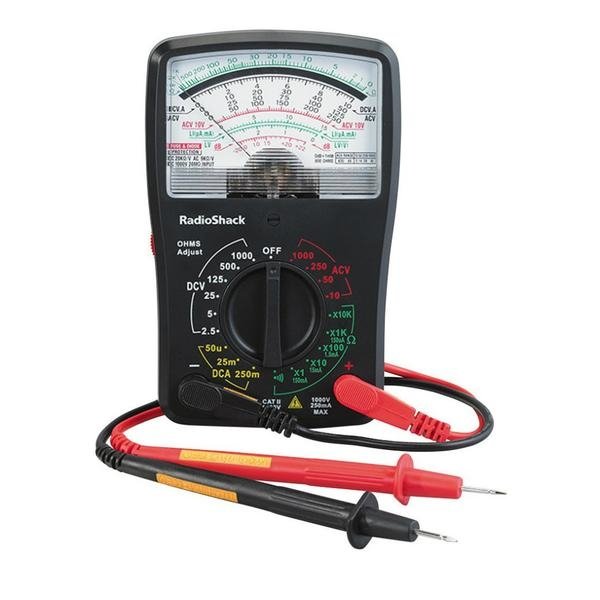

One thing about testing them this way, an analog meter is the best type to use. That is because the digital meters tend to jump a lot and you could miss a problem because of that.

There are only 3 wires. One has 5 volts from the computer. One goes to ground at the computer and the third is the variable signal line that goes to the computer. The TPS itself works just like a light dimmer or volume control.
The outer pins are the 5 volts and ground and the middle is the signal.

I might want to look for an analog meter but then unsure how to go about testing stuff with that as well

The sweep test is looking for a constant circuit AND that the resistance change from closed to open throttle is smooth and constant.
The outer pins are connected to each end of the resistor. The center pin wipes across that.
The reading you get depends on how the TPS has failed.
On a graph a good sensor will have a constant slope across the sweep.
A bad one may have a break in the film and suddenly the graph will go open circuit, Or it will have a sudden change of voltage.
It may have spots where it is worn but not broken. On those there will still be a change but depending on the wear location you may see just a slight blip on the graph or scope or on an analog meter. BUT that blip could easily be fast enough that a digital meter won't update fast enough to catch it.
The black lead depends on which way you test. The way Paul was testing on the vehicle the black lead goes to ground.
Off the vehicle and doing a resistance check you would connect the lead to one of the outer pins. This test works the same way for many potentiometer type sensors, like a fuel level or light dimmer.
