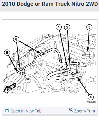

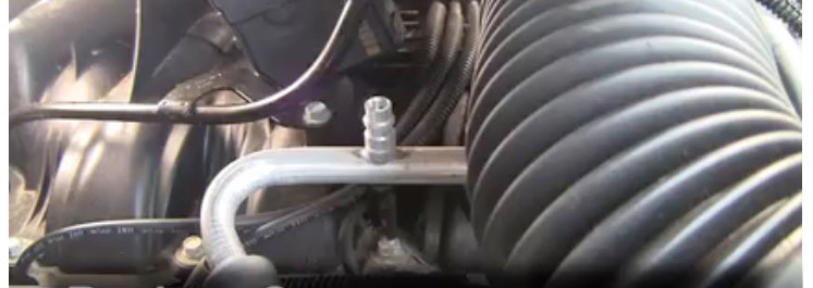

checking and recharging my A/C system
2010 DODGE NITRO
100,000 MILES • 6 CYL • 2WD • AUTOMATIC
LINDA ALCANTAR
don't know where the ports are located under the hood.
Jul 18, 2021 at 2:29 PM
SQM
  • 6,383 POSTS
If you are trying to recharge the AC system, you will need to use the low pressure side for the DIY kit. I have attached pictures as well as some helpful articles:
https://www.2carpros.com/articles/air-conditioner-how-to-add-freon
https://www.2carpros.com/articles/air-conditioner-leak-detection
https://youtu.be/4EqdrBVb0sY
Jul 18, 2021 at 3:11 PM
