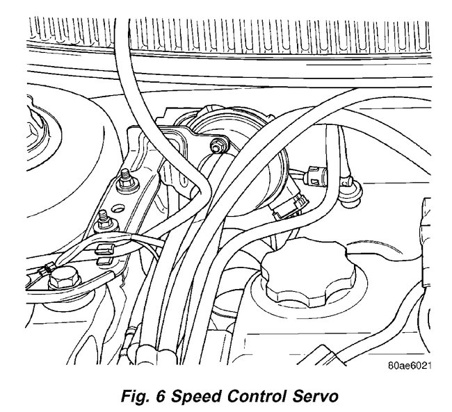

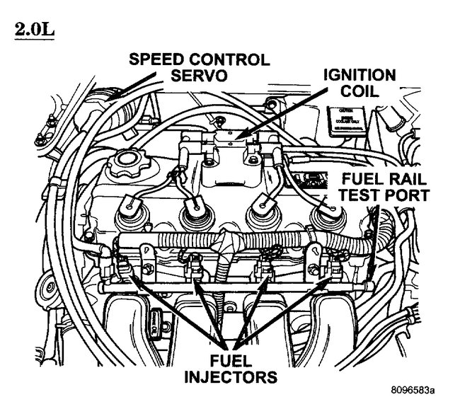

Since the two related to the cruise can be the result of a bad speed control servo, I think you have a vacuum leak issue. I need you to check the speed control servo under the hood for a vacuum leak, cracked or disconnected hoses, and the servo itself for leaks.
Here is a link that shows how to check for a vacuum leak:
I have attached pictures of the servo so you can easily identify it.
Check that and let me know what you find.
