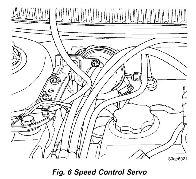

I bought this car about three month as ago. I’ve fixed a few minor problems but the car has basically been running really good. The other night I noticed the cruise control lever behind and under the steering wheel I had never paid attention to before and decided to see if I have working cruise control on my car. Cruise light flashed on the control panel and turned off and the cars cruise control does not work. Later my check engine light came on and I’m getting three codes for the cruise control. But my problem is my transmission has started slipping since I tested my cruise control and now I think it is in limp mode and my car is reading code 700 also. Can the cruise control not working cause my transmission to mess up or are these two separate problems. I do not know if it’s my transmission that’s going out or if it’s something way less serious and I don’t have money to spare to take it in right now and have it looked at.

A P0700 is a generic code which is indicating there are trouble codes stored in the vehicles transmission control module (TCM). Can you tell me what the other codes are? You indicated there are three.
I have to be honest, the CC is actuated with engine vacuum which is controlled by the power-train control module. Chances are it isn't the cause, but it is odd that it happened this way. Let me know what codes you found. Also, to read transmission codes (TCM) requires a specific type of scanner. Ones they have at parts stores most times only read P codes like the P0700.

I think it’s odd too. Now I wish I never noticed the little cruise control arm at all. The codes are 0700, 0513, 0582, and 0586.

I was wrong, two codes are cruise control. The third is from my daughter trying to start the car with my door only spare key. Pretty sure that’s not causing my problems though.

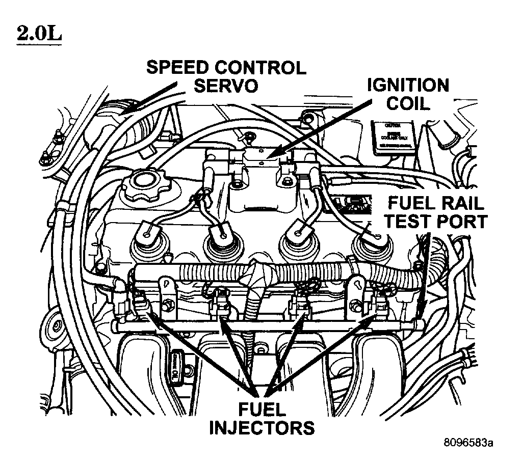

Since the two related to the cruise can be the result of a bad speed control servo, I think you have a vacuum leak issue. I need you to check the speed control servo under the hood for a vacuum leak, cracked or disconnected hoses, and the servo itself for leaks.
Here is a link that shows how to check for a vacuum leak:
I have attached pictures of the servo so you can easily identify it.
Check that and let me know what you find.

I sprayed pretty much every hose under my hood and no changes at all. I have done this test before on another car so I know what to listen for. My car doesn’t run rough or make any noises. I’m on top of maintenance and all the repairs. About two months ago I had a month of one small thing after another needing to be replaced, the camshaft position sensor, thermostat, power steering pulley, alternator, fuses, a blinker switch, motor mounts, and I just fixed my leaky transmission pan and put a new filter and gasket last month and haven’t lost any fluid since. The first time it felt like the transmission slipped I hurried and added some Lucas transmission stuff just in case it’s going out n that stuff might be legit. Figured don’t wait. And now this. And my car sits the majority of the time so I’m not out tearing it up or anything. I can’t afford a big problem right now.

I have thought long on this issue. I have to be honest, if the transmission is slipping, I can't see anything between the CC and transmission that would cause a slipping. The codes you originally listed are P type codes and not specific transmission codes. I really feel you need to have the computer scanned with a scanner which can read codes from the TCM.
