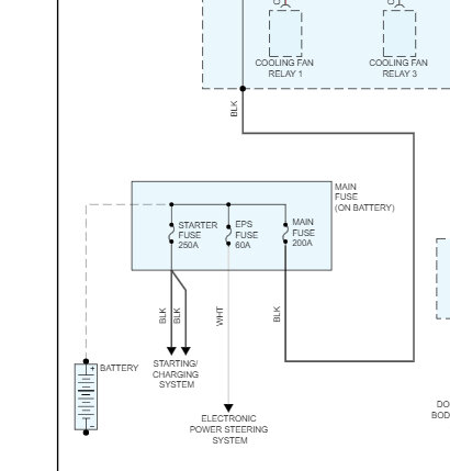

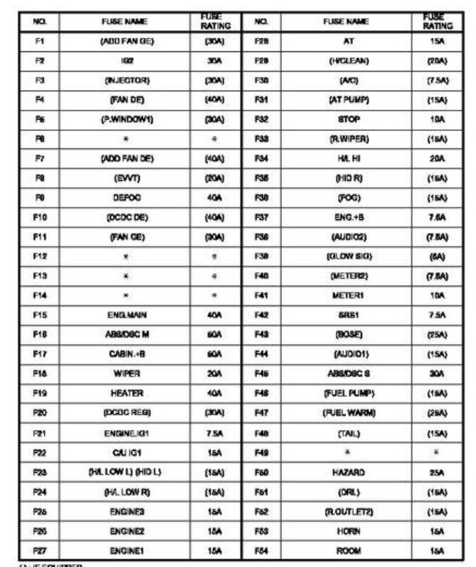

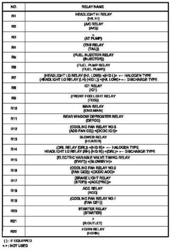

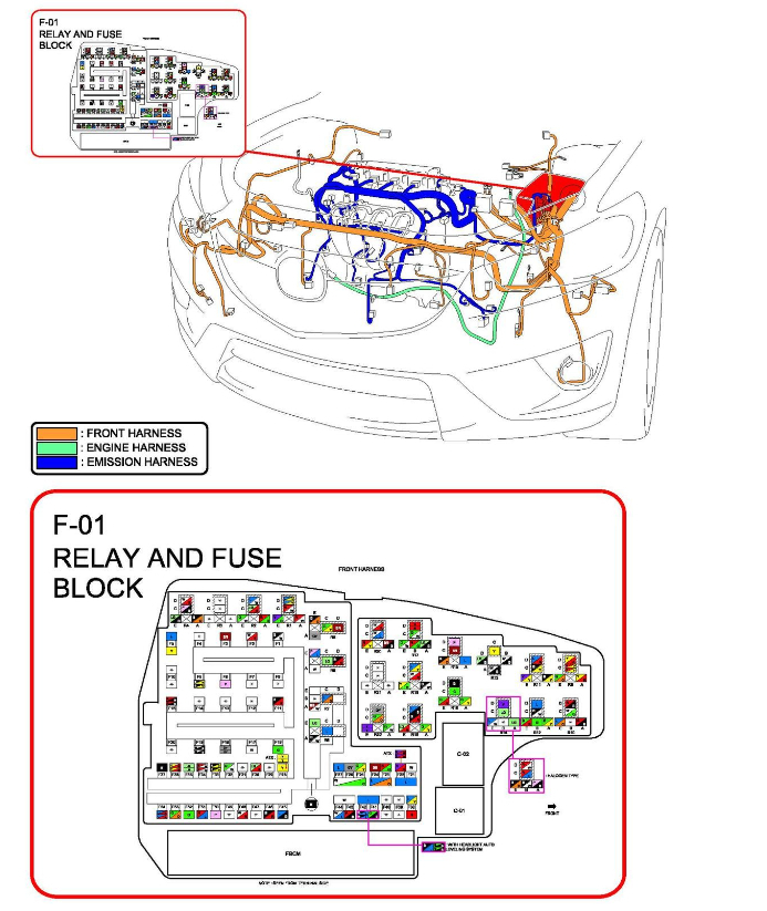

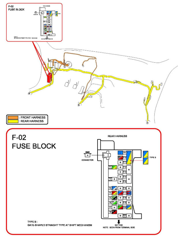

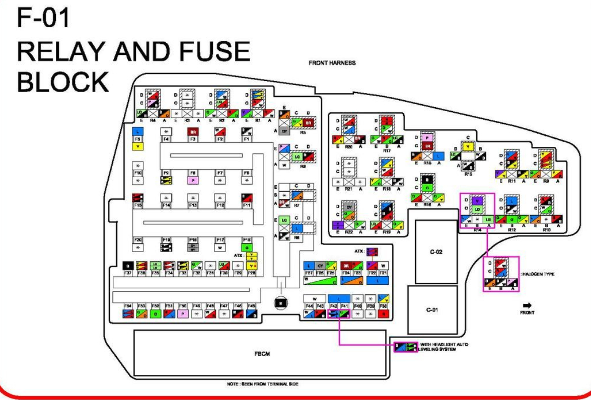

Had a power surge..now my high beams,blinkers,heat/AC stopped working. Checked the fuses now what?
Nov 14, 2023 at 1:23 AM
  • 55,214 POSTS

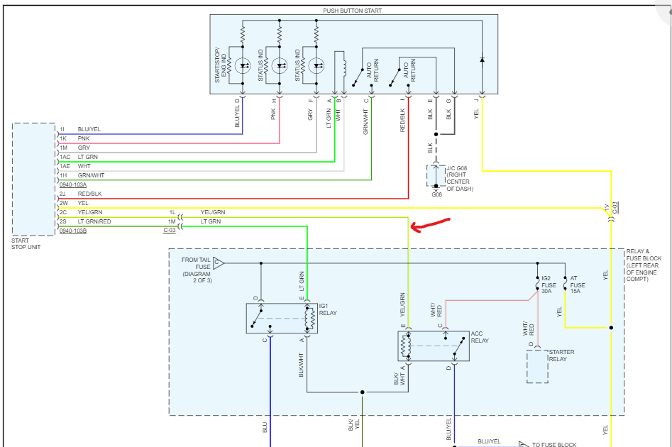

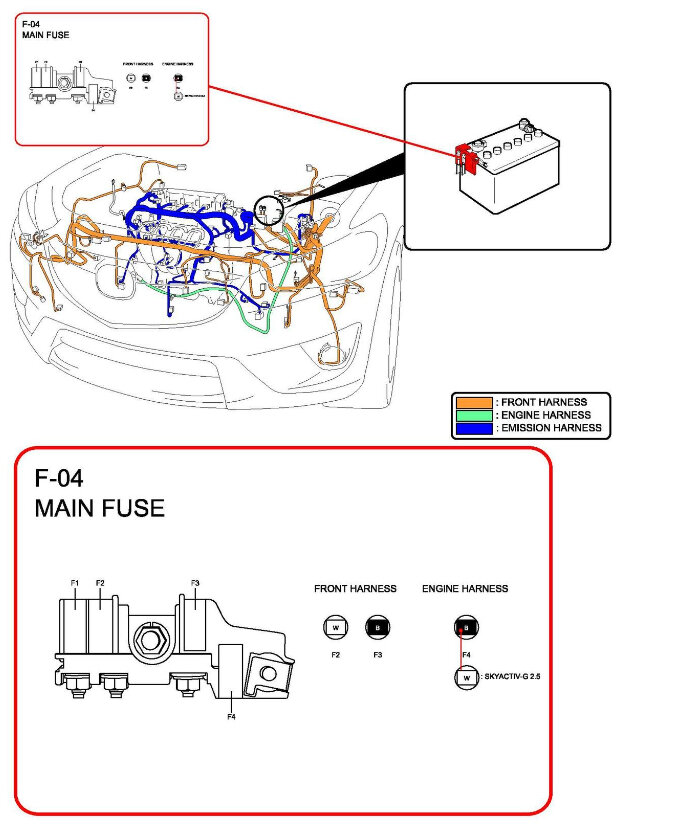

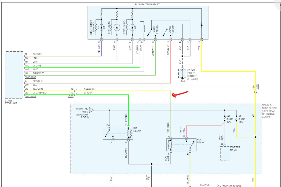

Can I ask how the power surge happened? Also did you check the main fuses for power here are the locations, if these fuses are okay let's check for power coming from the start stop unit.

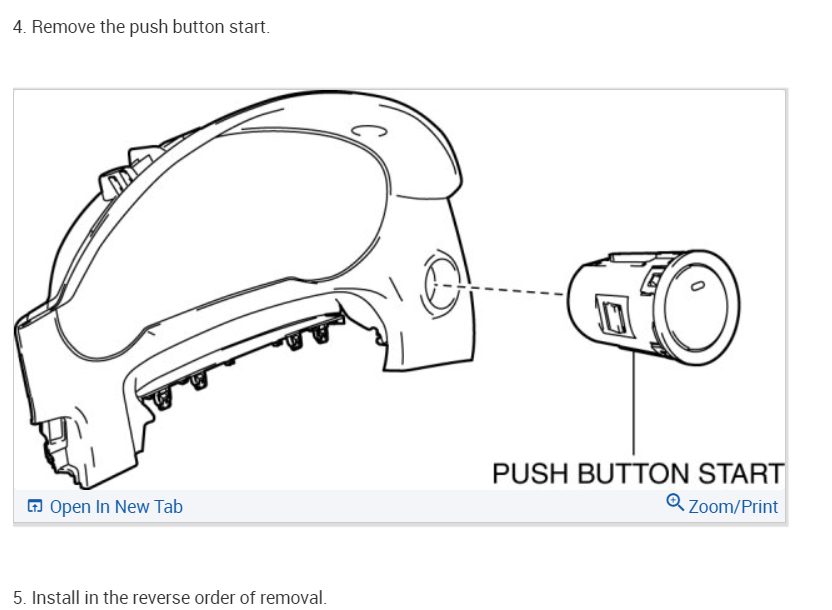

Here is a guide to help and the wiring diagrams to help you see what I am talking about:
Please see if the fuses for the systems are getting power. Check out the images (below). Let us know how it goes.
Nov 14, 2023 at 4:02 AM
JEREMIAH HOPKINS
Well, looking at that fuse is connected to the battery and then putting it back together or who knows. Everything up and working again woo-hoo. thanks for your help. PS. It all started from putting in a fuse tap....
