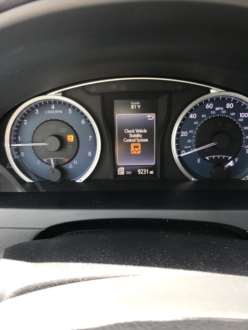

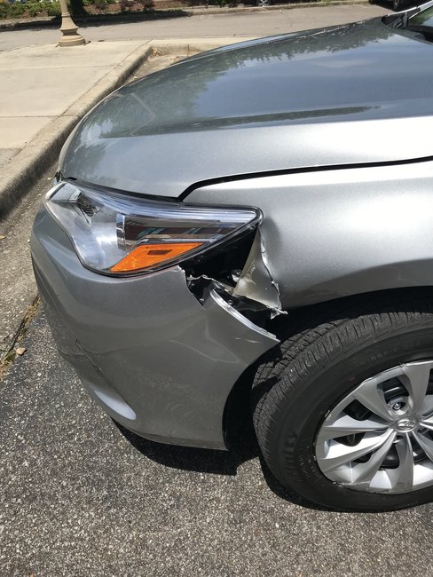

My 2017 Camry was in an accident. Immediately after the accident, the dash display indicated, “Check Vehicle Stability Control System”. The car returned home (less than 5 miles) and still had that indication. It remained parked, and after some internet searching it seemed worth checking for an OBD-II code. I did try to do that, but by the time I had the code reader connected the “Check Vehicle Stability Control System” appeared to clear itself before I even had a chance to read the code. Is that surprising?

This sounds like one of the wheel speed sensors has gone out or is not connected. To find out which one here is a video to show you how to get the codes to see which one it is or if you have a different issue. Can I ask which part of the car got in the accident?

In the accident, the car was hit on the driver’s side front fender and wheel. A picture is attached.
I have also attached a picture of the indicator stating “Check Vehicle Stability Control System”.

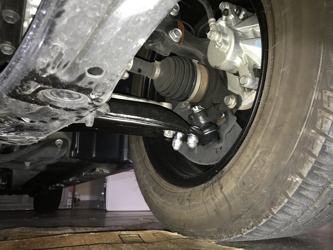

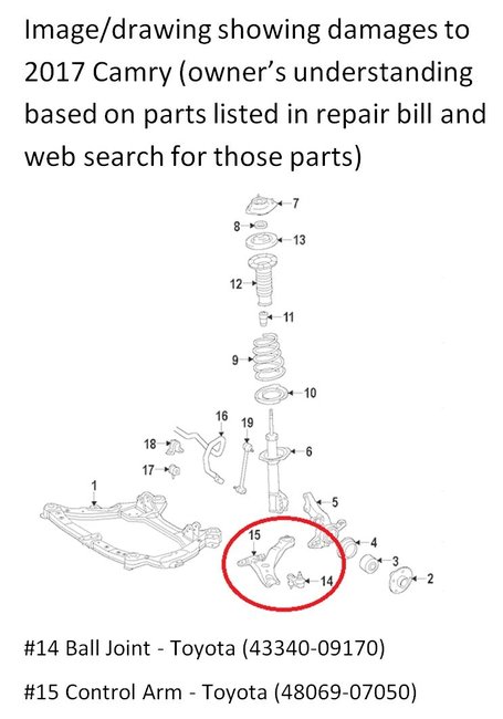

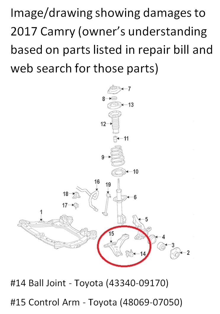

The car was taken to a Toyota dealer's body shop for repairs. The bumper cover, left head lamp, left front fender and a hubcap were replaced. The body shop sent the car to the dealer's mechanic shop.
From a mechanical standpoint, the front left wheel was replaced, re-using the existing tire which was balanced. The repair bill also indicates two parts that may be related to the "Check Vehicle Stability Control" indicator were replaced. I did a web search on the part numbers to determine that these were (1) Ball Joint - Toyota (43340-09170), and (2) #15 Control Arm - Toyota (48069-07050). The repair bill also indicates that an alignment was done.
I can see the new parts near the wheel by looking under the car from the front. One of the attached pictures shows those new parts, along with the new (3) Fender Liner - Toyota (53876-06200) and (4) Wheel, Steel - Toyota (42611-06B10). The shiny black painted metal distinguishes the new parts from the original which have some accumulated road dust on them.
The repair bill also indicates scanning before repair and scanning after repair, but does not report any findings.
The "Check Vehicle Stability Control System" warning is not present.

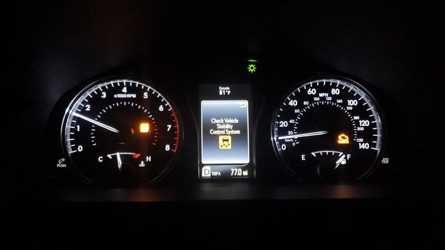

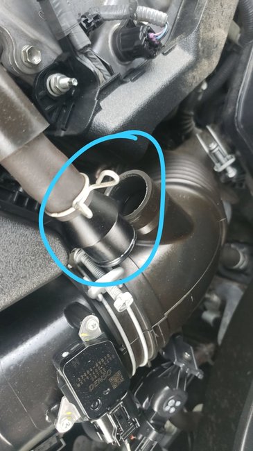

URDJ07
I had the same issue and after a research on the internet, I could not find that much information, My car is a 2017 Toyota Camry LE, the light came on accompanied with rough idle also some transmission failure, when I opened the hood to check was going on, I immediately noticed that an air hose that come from the engine to the hose that connects the throttle body and the air intake box was disconnected, I put it back in but the light was still on, so I disconnected the battery terminals for 1 min to reset all codes, after reconnecting the battery terminals, the check engine light and warning message went away and the car was functioning perfectly as expected, later that day I serviced the throttle body and performed an idle re-learn, and the car is working very smooth. Check the attached images, I hope this helps more people.
