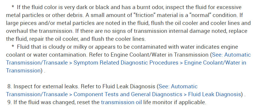

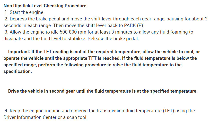

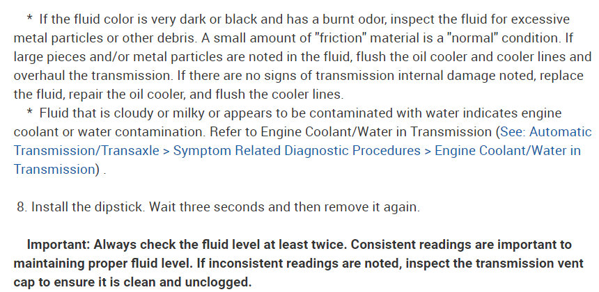

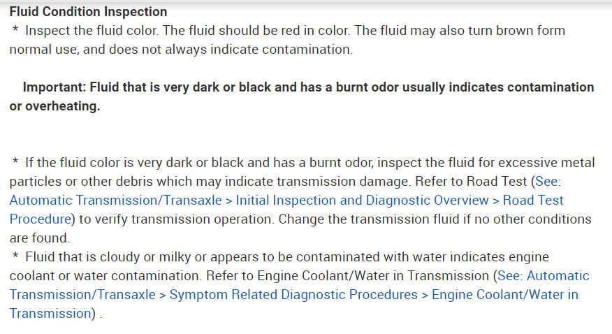

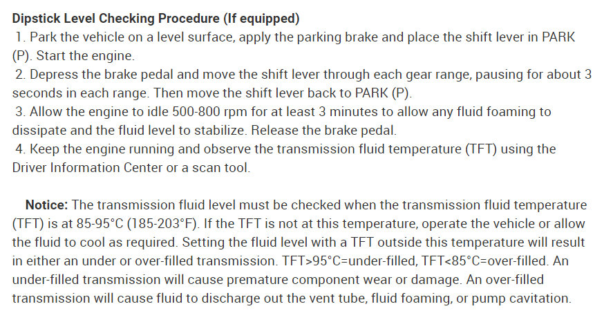

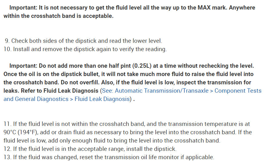

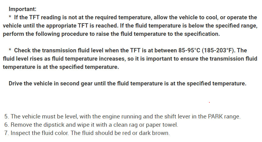

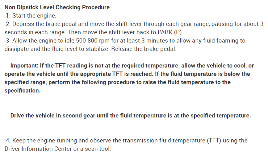

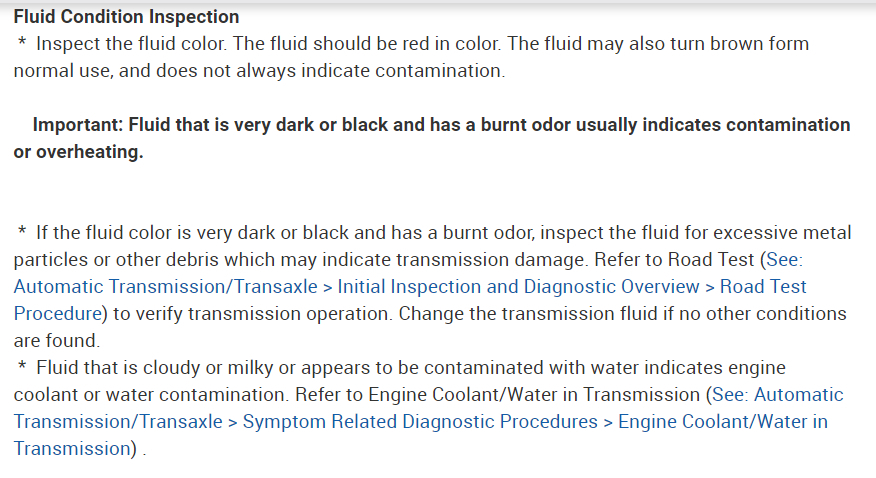

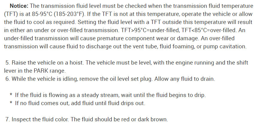

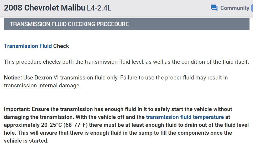

Hi, where is the transmission fluid level plug located?
Thanks in advance,
Blake
Dec 20, 2020 at 3:47 AM
DANNY L
  • 5,648 POSTS
Hello, I'm Danny.
As far as visually checking the transmission fluid level I found this video for you.
https://youtu.be/ualklGHjBYM?t=3
I've attached picture steps below describing how to check the fluid level as well. Hope this helps and thanks for using 2CarPros.
