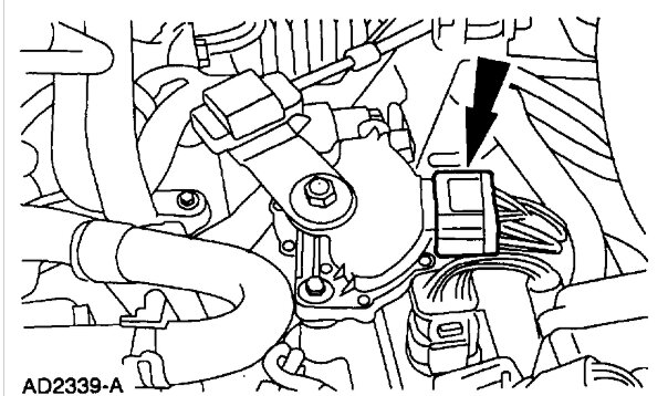

Them first thing I would do is check the transmission fluid level. Next, lets run the codes to see which ones are stored, this video should help.
https://www.youtube.com/watch?v=LBCpCWEFnTg
Also, check the wiring connector at the neutral safety switch (gear range sensor) Let me know what you find.

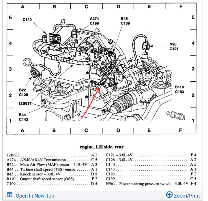

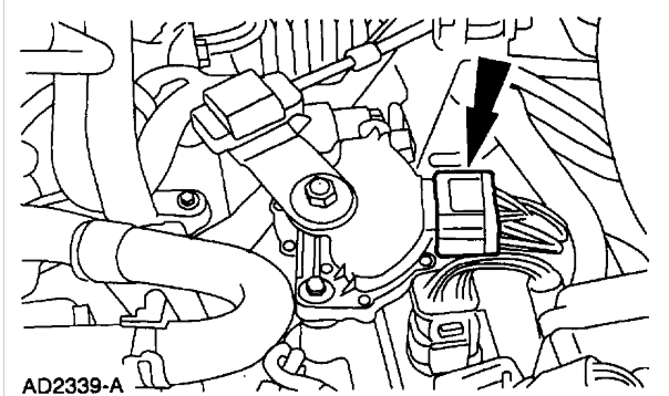

The wheel speed sensos are for the ABS system so they should not affect the transmission. I would also check the input shaft speed sensor which could have been bumped when you were doing the work. Here is the location of the sensor and what the gear range sensor should look like as well. Check out the images (below). Please let me know what happens.

I found the cause of the problem. The wire behind the #28 fuse (HEGO Sensor Transmission Shift Solenoid, Canister Vent, A/C Clutch Relay, Thermactor Bypass Solenoid) was loose. The wire had not pulled out completely. It was pulled out just enough to not make contact so visually it looked fine and when I tested, with the fuse in place, the pressure of holding my probe against the fuse it made contact so I got continuity through the fuse. But as soon as I removed my probe it would disconnect. Had me chasing my tail there for a min. The car runs fine now.
Thank you for all your inputs.
