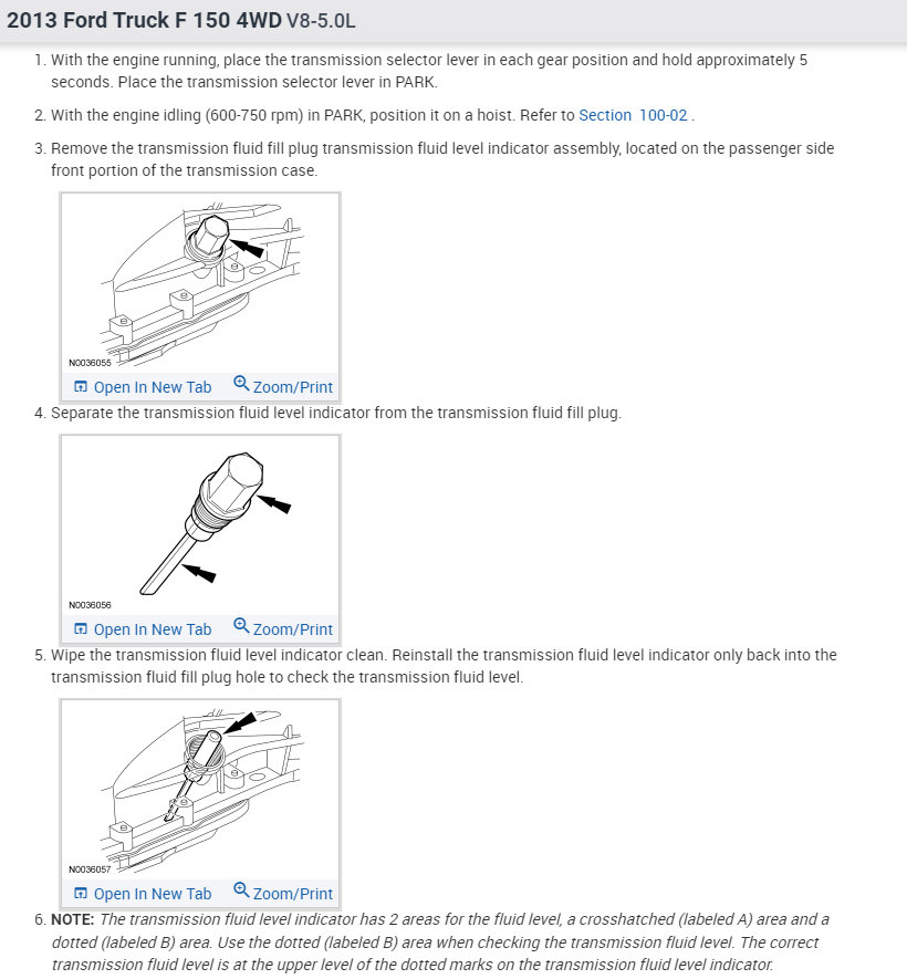

How to check transmission fluid in this truck?

Check transmission fluid.
Feb 6, 2022 at 2:59 AM
SQM
  • 6,383 POSTS

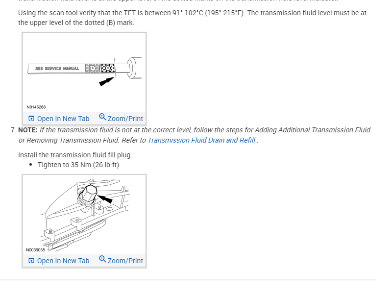

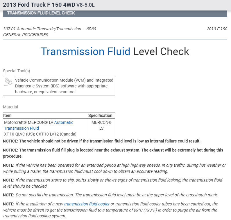

The transmission fill plug and the level indicator is located on the passenger side of the vehicle, front portion of the transmission case. You will have to access it from under the vehicle.
I have attached diagrams and the fluid checking procedure below.
https://www.2carpros.com/articles/how-to-check-and-add-transmission-fluid
