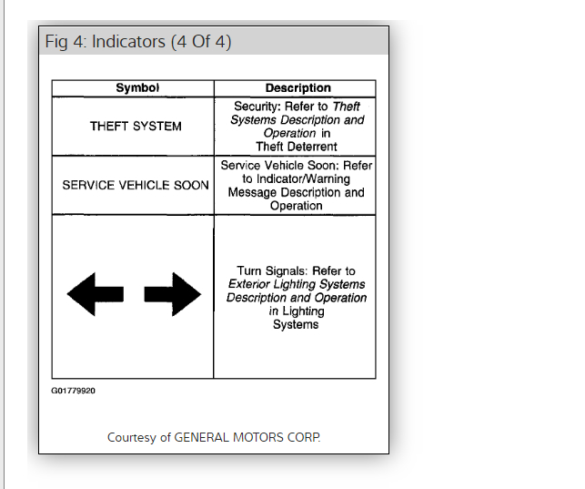

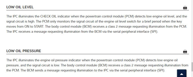

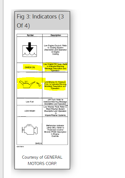

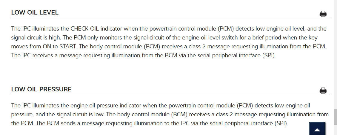

My check oil light came on, but it is not the dripping oil can symbol it just says check oil. does that mean i need to change my oil or add oil?
Sep 12, 2019 at 4:14 AM
SCGRANTURISMO
  • 4,897 POSTS

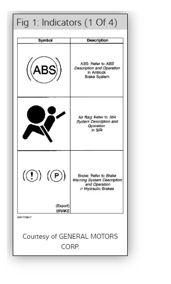

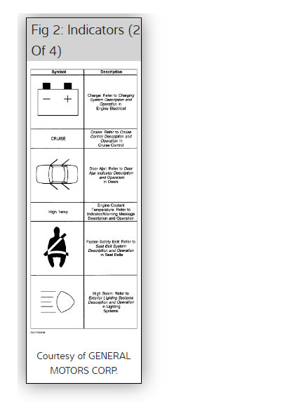

I have included the list and description of your vehicle's warning indicator lamps with their meanings in the diagrams down below. Please go through these guides and get back to us with what you are able to find out.
Thanks,
Alex
