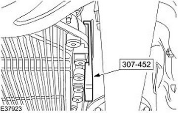

Next, low transmission fluid can cause problems too. Here are the directions for checking transmission fluid level. No longer is it a 10 second check using a dipstick. Here are the directions. All attached pictures correlate with these directions.
_____________________________
Transmission Fluid Level Check
Special Service Tools
picture 1
Adaptor 307-452
Check

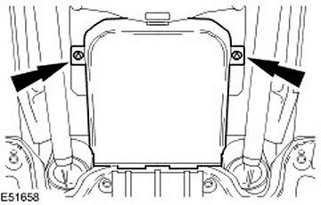

5. Raise and support the vehicle.
picture 2
6. Remove the transmission undertray.

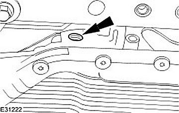

7. Place a suitable container under the transmission fluid filler plug.
WARNING: Make sure that care is exercised near rotating parts. Failure to follow this instruction may result in personal injury.
picture 3
8. With the engine running, using the special tool remove the transmission fluid fill plug.
- Remove and discard the transmission fluid fill plug.

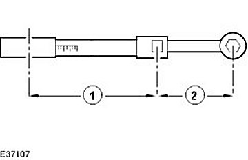

12. Using the special tool and a torque wrench, tighten the transmission fluid fill plug.
- Tighten the transmission fluid fill plug to the torque given by the calculation
- To make sure the transmission fill plug is torqued to the correct specification. Using the special tool and a torque wrench the following calculation steps must be followed.
Step 1.Multiply 35 Nm by the effective length of the torque wrench (1).
Step 2.Add the effective length of the special tool (2) to the effective length of the torque wrench (1).
Step 3.Divide the total of step 1 by the total of step 2.
Step 4.Set the torque wrench to the figure arrived at in step 3.
- Tighten the transmission fluid fill plug to the torque given by the calculation.
