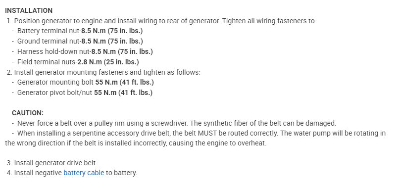

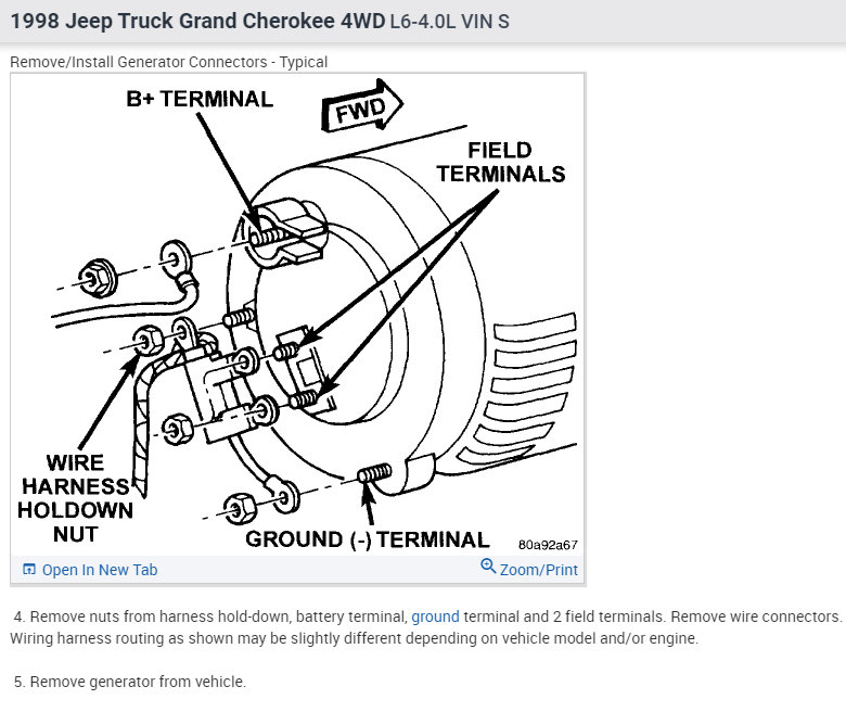

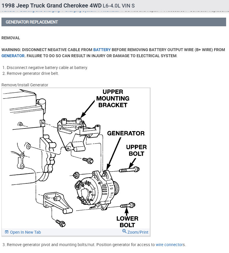

hello, i have the vehicle listed above Grand Cherokee Laredo. So, what's going on is, when i turn on my A/C unit my check gauge light comes on plus i get a warning buzzer, and my voltage gauge shows not charging, with an external voltmeter in line voltage shows 0 when i turn the A/C unit off and bring RPMs up to 2,000, voltmeter shows charging at 13. volts again
Any idea what is going on?
Thanks
Jul 27, 2022 at 10:08 AM
SQM
  • 6,383 POSTS
It sounds like the alternator is not performing under load.
To figure out if it is indeed a bad alternator, you will have to remove it and have it bench tested. Most auto parts stores have bench testers for alternators.
Here is a helpful guide:
I have attached the alternator replacement procedure below for your reference.
Let me know of any questions.
