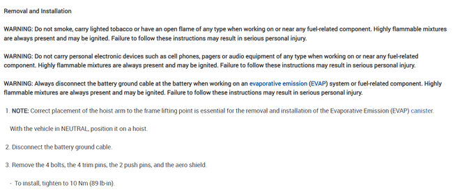

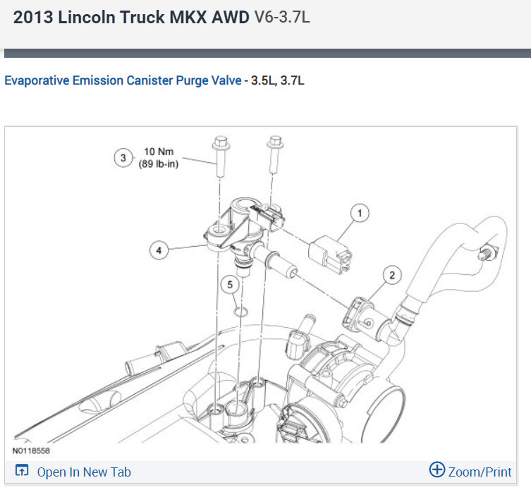

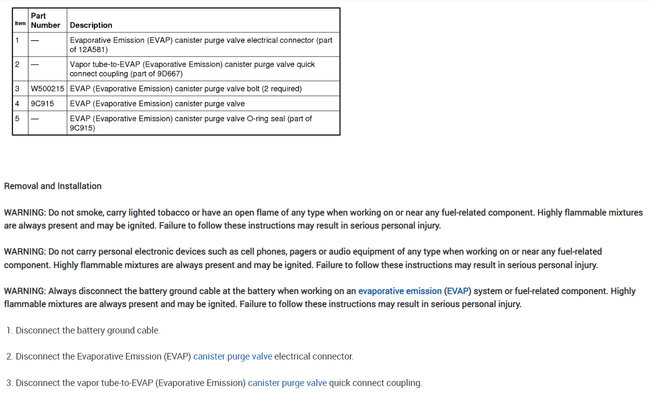

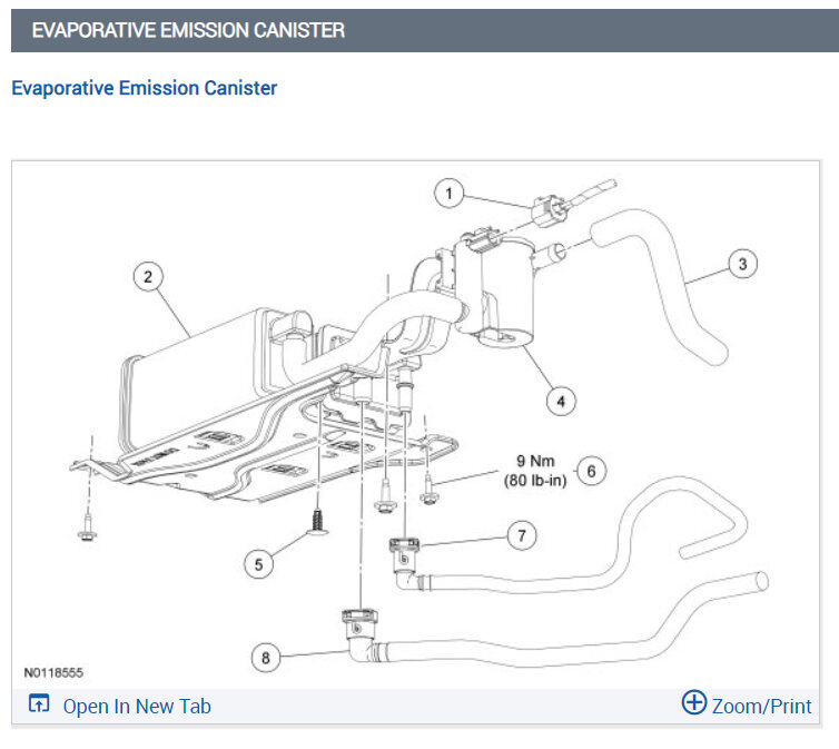

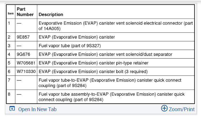

I would use a flashlight and check the EVAP lines to make sure none have fallen off or are cracked or damaged. Also, I have seen the EVAP purge valve stick on which can cause the light and the engine low power problem as well. Here is the location of the purge valve which I would remove and see if you can blow air through it and if so, the valve is bad. I also included the EVAP canister hoses and location so you can check it out.

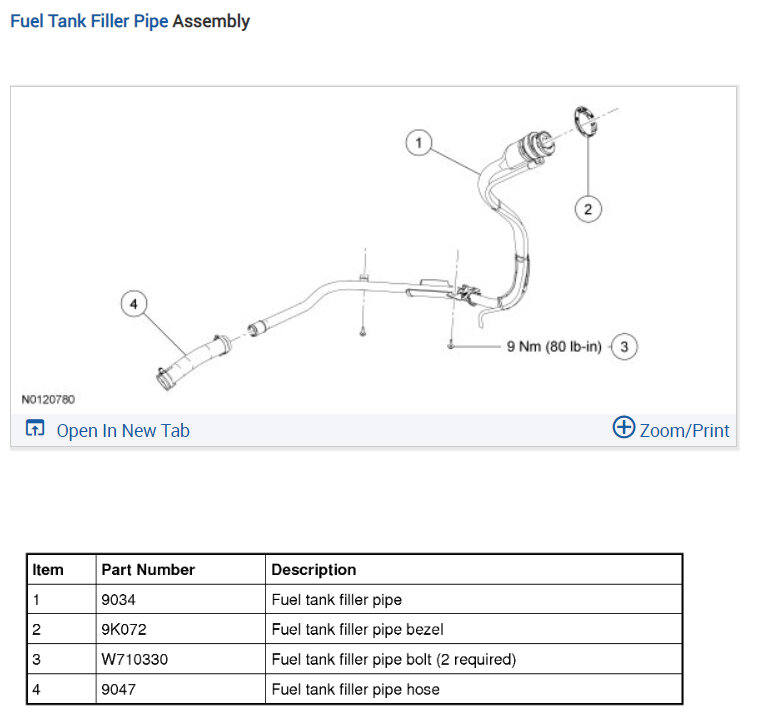

They did have problem with the Non cap style of gas fill which will need to be replaced if leaking. To tell if it is leaking you can remove it to see if you can blow air through it as well.
Check out the images (below). Please upload pictures or videos in your response of any problems so we can see what to help you with.
