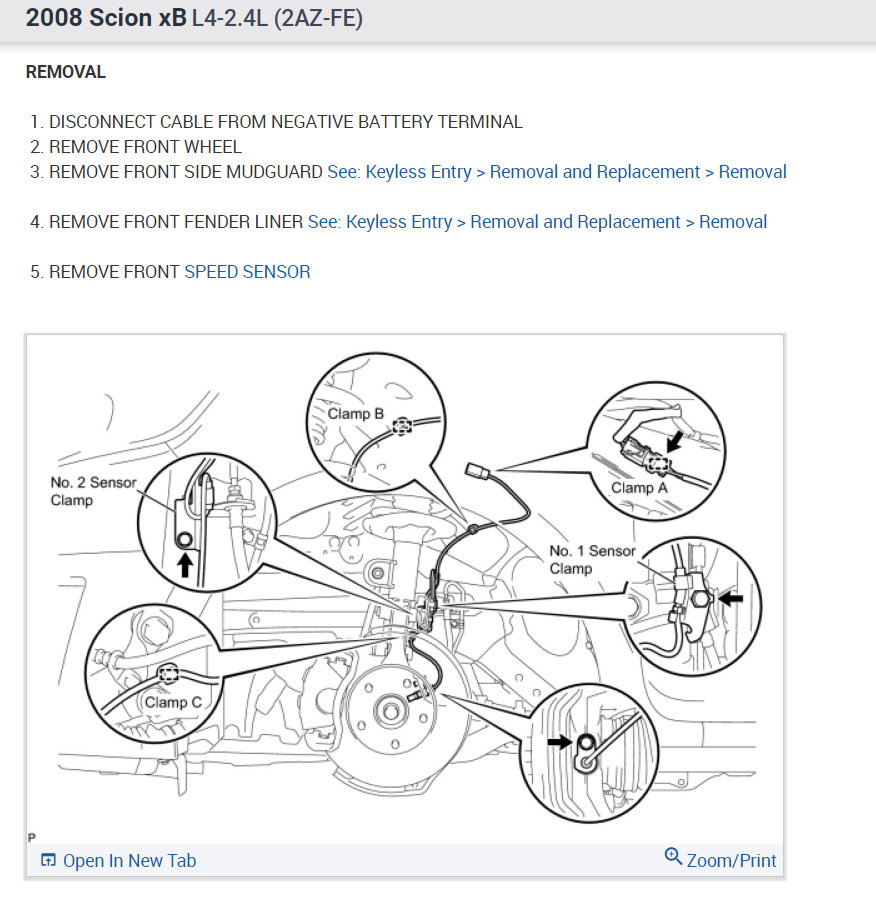

I got a co2 upstream code. I replaced it but the lights still wont go off. I tried disconnecting the battery but the light comes on again. will the lights go off with driving?
Aug 29, 2019 at 11:09 PM
Good morning,

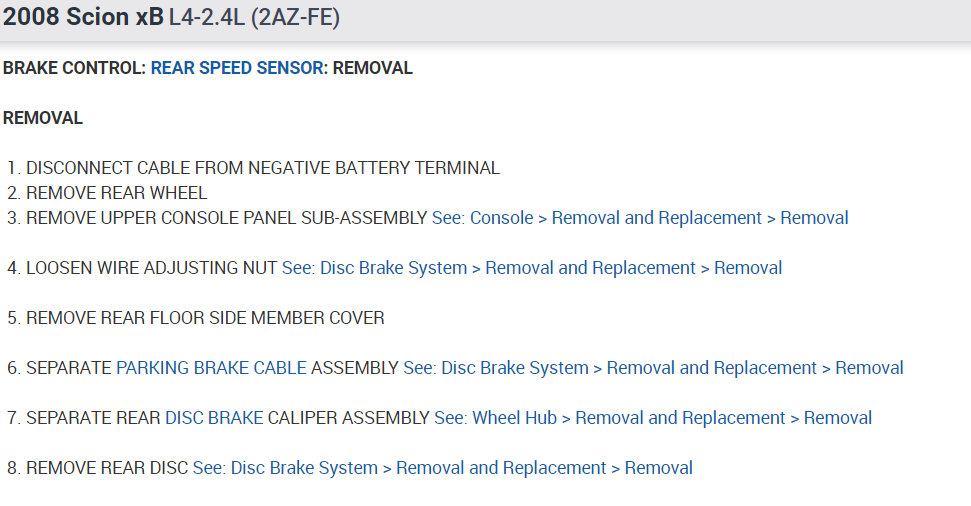

It sounds like you have a wheel speed sensor that is not working correctly but to be sure let follow this video on how to get the codes to help tell us which sensor is out.
https://youtu.be/rTtAnsOlZU4

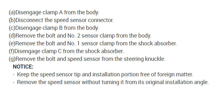

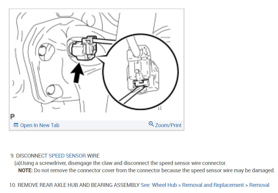

Here are the instructions below to show you how to change out the wheel speed sensor. Check out the diagrams (Below). Please let us know what you find. We are interested to see what it is.
Aug 29, 2019 at 11:37 PM
