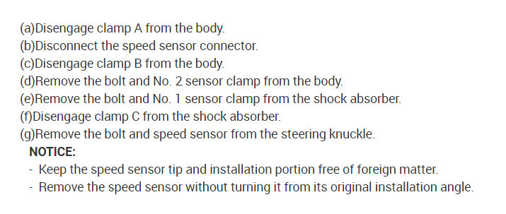

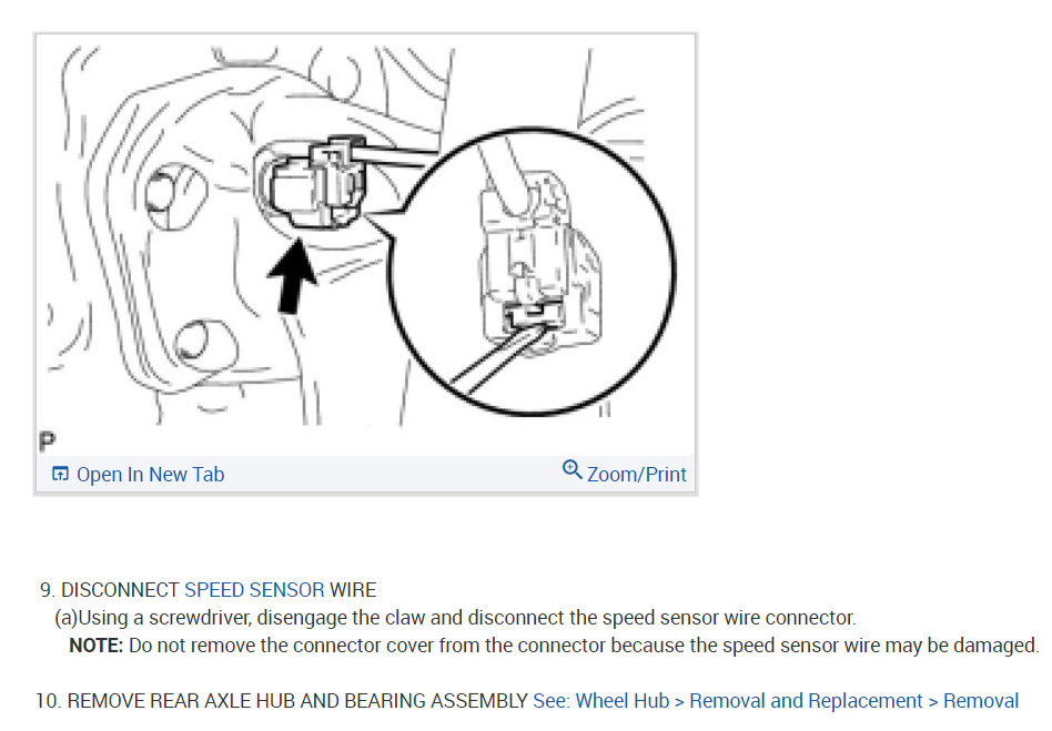

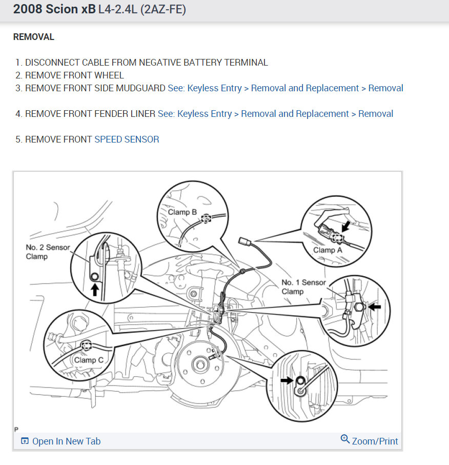

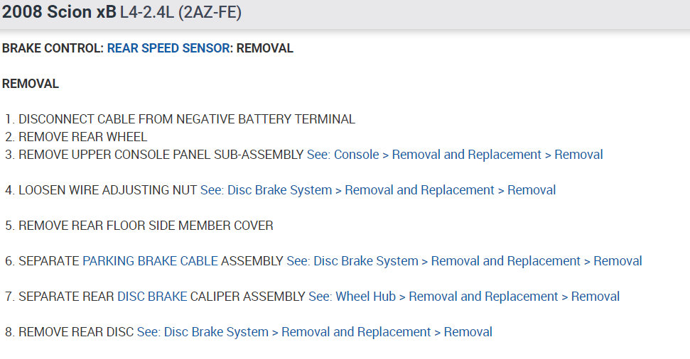

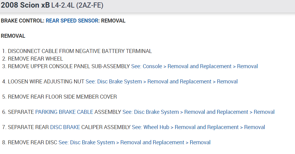

Here are the instructions below to show you how to change out the wheel speed sensor. Check out the diagrams (Below). Please let us know what you find. We are interested to see what it is.
