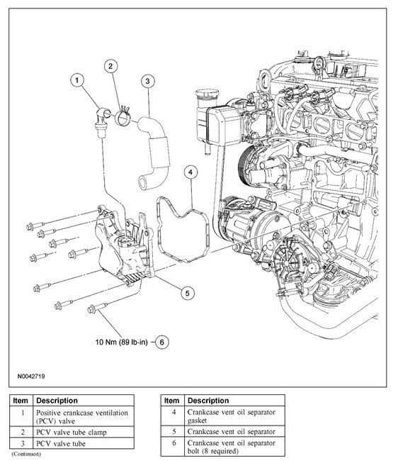

I was told that the PCV valve might need a change, so I bought a new one and when I wanted to replace it, I had no idea where to locate it -.-

As for the PCV blow by, that will not really cause any drivability issues also but it can cause seals to blow and create an oil leak if it is plugged up. Every vehicle is different with the pcy system. European vehicles you will feel a slight vacuum when you place your hand over the oil fill hole. Sometimes the pcv system will have an internal leak and make a squealing or honking noise?
To start with I would recommend you replace the oil separator. That box is the heart of the pcv system. You will need to remove the intake manifold to access it. Once there you can actually replace the valve and I recommend you replace the hose. See the picture I posted.
Hope this info helps and lets us know if you did the repairs.
