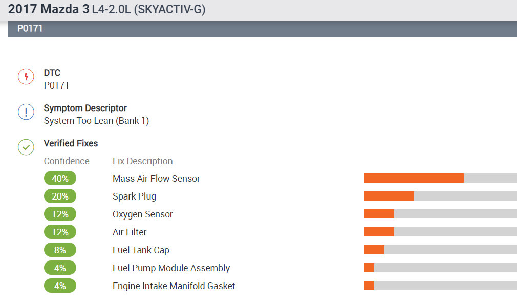

i can feel it shake and vibrate while i drive. I changed spark plugs and MAF did not really help but the code on the OBD changed to suggest p0171 reinstall air duct intake.

Yep, it sounds like you have a cylinder misfire which will cause the P0171 code. Let's remove the spark plugs and do a compression test. Remove all spark plugs and this guide will should you how:

But would a bad coil pack cause the system to run too lean? That is what the check engine code is saying for P0171.
Aug 30, 2022 at 1:49 PM
  • 55,561 POSTS
Yes, it is for a lean system which a cylinder misfire will cause, 14-1 14 parts air to one part fuel, so 14 parts of air enter the system. Lean

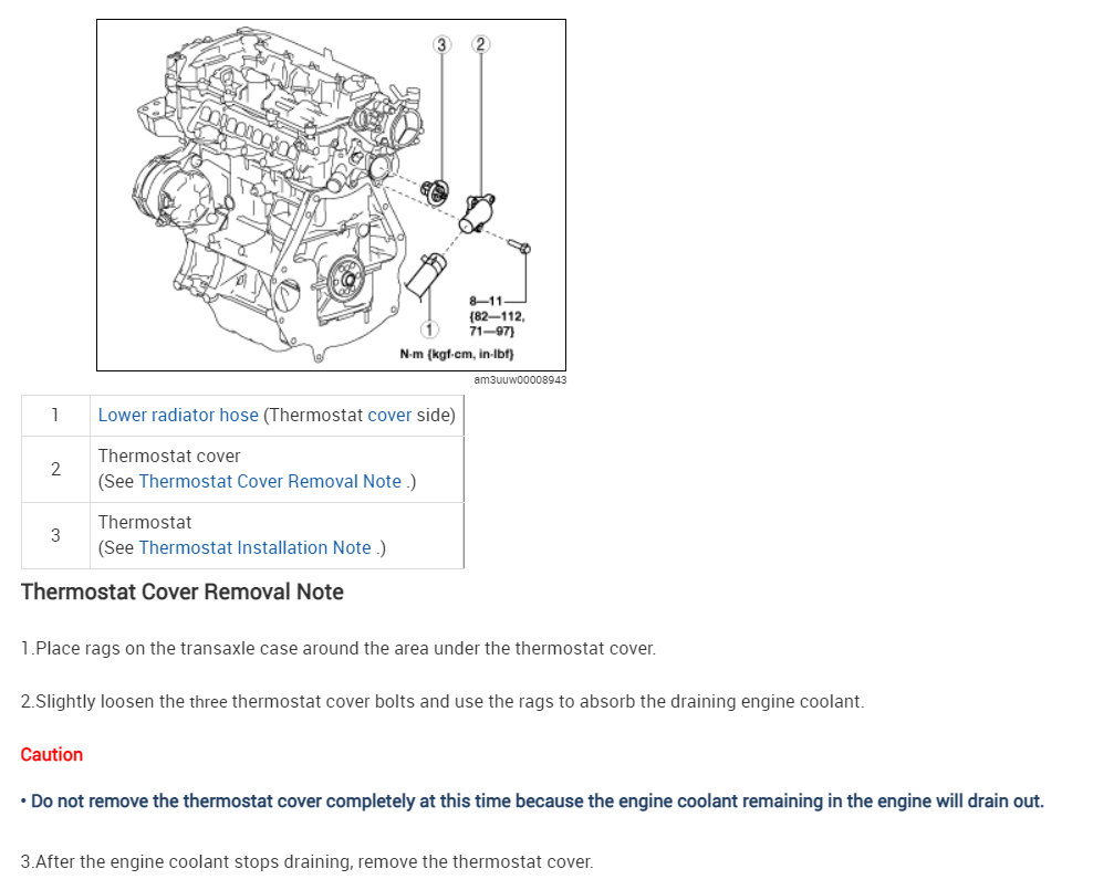

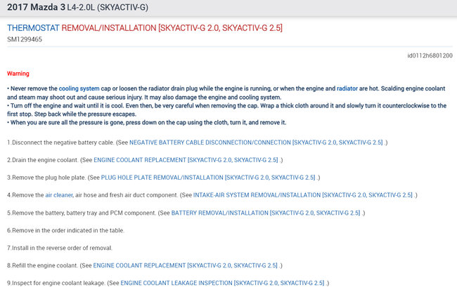

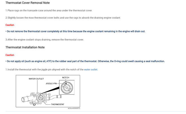

  • 55,561 POSTS
P0171 System Too Lean to the overheating problem will not affect this. Have you tried to replace the thermostat?
Here is a generic guide so you can see what you are in for with instructions for your car in the images below:
And this can help as well:
https://www.2carpros.com/articles/engine-overheating-or-running-hot

I have not changed my thermostat i was stuck between changing the thermostat or coolant sensor. So, do you think the symptoms i am having would be caused more from a faulty thermostat and not a coolant temperature sensor?

I did not see what to do with a thermostat test. Do i have to flush out the coolant to replace it or can i just replace it? I know some will shoot out.
Sep 7, 2022 at 5:47 AM
  • 55,561 POSTS
When you remove the thermostat, drop it into a pan of boiling water, it should open quickly. Yes, before you begin drain the coolant out of the system to minimize spillage.
