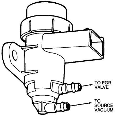

Hi Steve W. Here are the codes I got:
Engine Off:
332 Insufficient ERG Flow
558 ERG Regulator Valve Selenoid circuit failure
Engine On:
116 Engine Coolant Sensor Out Of Range
332 EGR did not open / respond
538 Sys didn't receive Goose test
536 Break on off open or shorted
632 TCS Should be cycled once between goose test

OOF... That's a few codes BUT only 3 really matter and of them one is likely causing another code.
Codes 332 and 558 are related. 558 is the EGR vacuum control solenoid. Either the wiring or the solenoid itself. If it doesn't operate properly the EGR doesn't work and you get the 332 code because the EGR isn't being properly controlled by the PCM. Check the wiring to it and you could test it's resistance as well if you have a Volt Ohm Meter. Damaged wiring or corrosion cause more codes than bad parts.
Resistance in the EVM coil 20-70 ohms
Code 116 points at the engine coolant temp. or intake air temp. being out of self test range. That could be for several reasons, bad sensor, loose connection or that the temperature during the test was under 50 degrees.
For both the test involves checking the wiring and connections and using a meter to back probe the connection and see what voltage each sensor is actually sending.
One or both are why the CEL light is on as both will call for it. Both can easily be diagnosed with a decent VOM and a couple sewing needles.

Nov 12, 2017 at 7:20 PM
ILIFTW8Z
  • 5 POSTS
Steve W! You were right!! Everything revolved around wiring! Fixed for $180 AND PASSED inspection/smog. Thanks so much!
