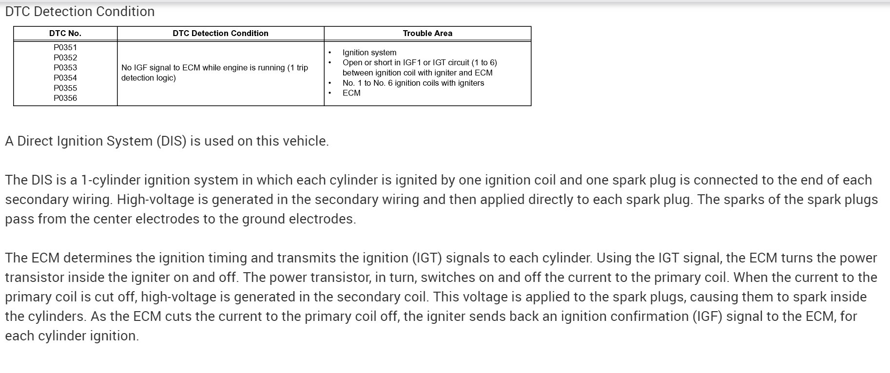

Direct Trouble Code(DTC) P0356 is a problem with #6 primary coil with igniter. DTC P0300 is a generic cylinder misfire code, and DTC P0301-0306 are misfire codes with the last number being the cylinder that's misfiring. Okay, your engine needs basically three things to fire. Fuel, spark, and compression. Since you have a spark related DTC, P0356, let's start there. Here is a link to a guide on how to check for spark.

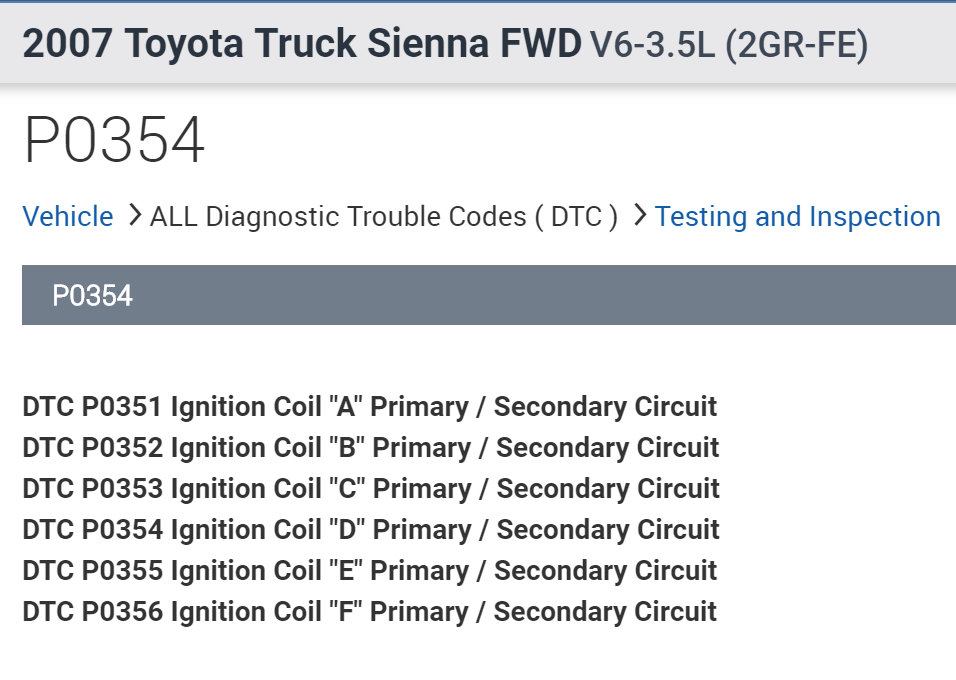

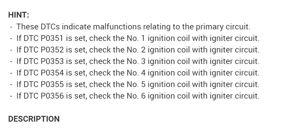

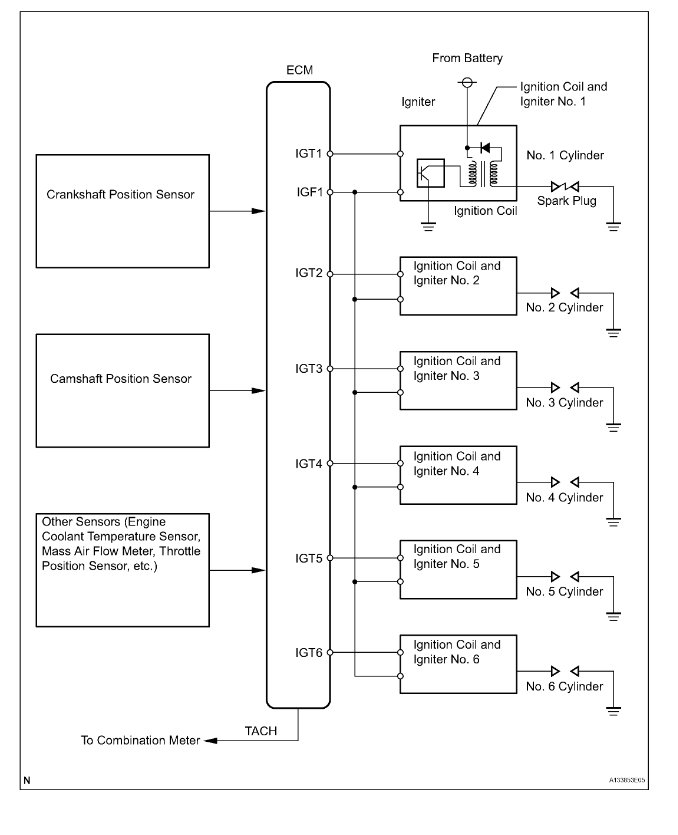

Thanks for information. I watch the video and try to test the cable and ignition coil, my cable has 4 pins and I was not sure which one need to be tested. I tried any way with out under standing the pin test with multi-meter. I did the spark test and spark was their. I swap my ignition coil from #6 to #4 position and scan, this time the result was DTC P0354, this tells me that ignition coil is not performing its function. Is this coil can be fix?

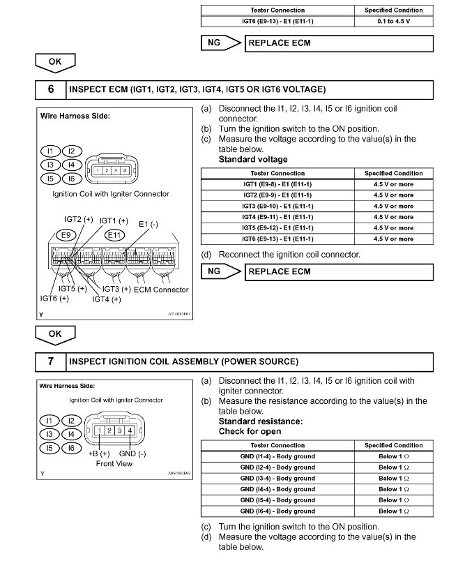

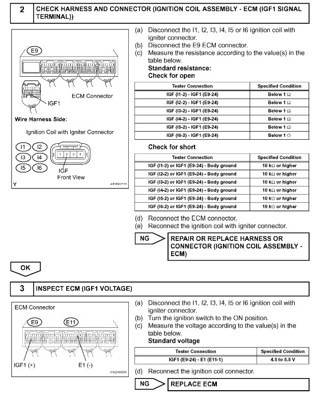

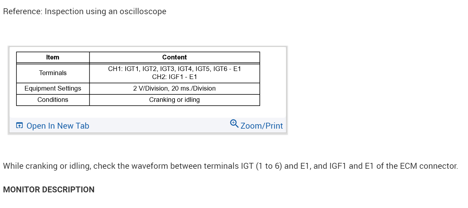

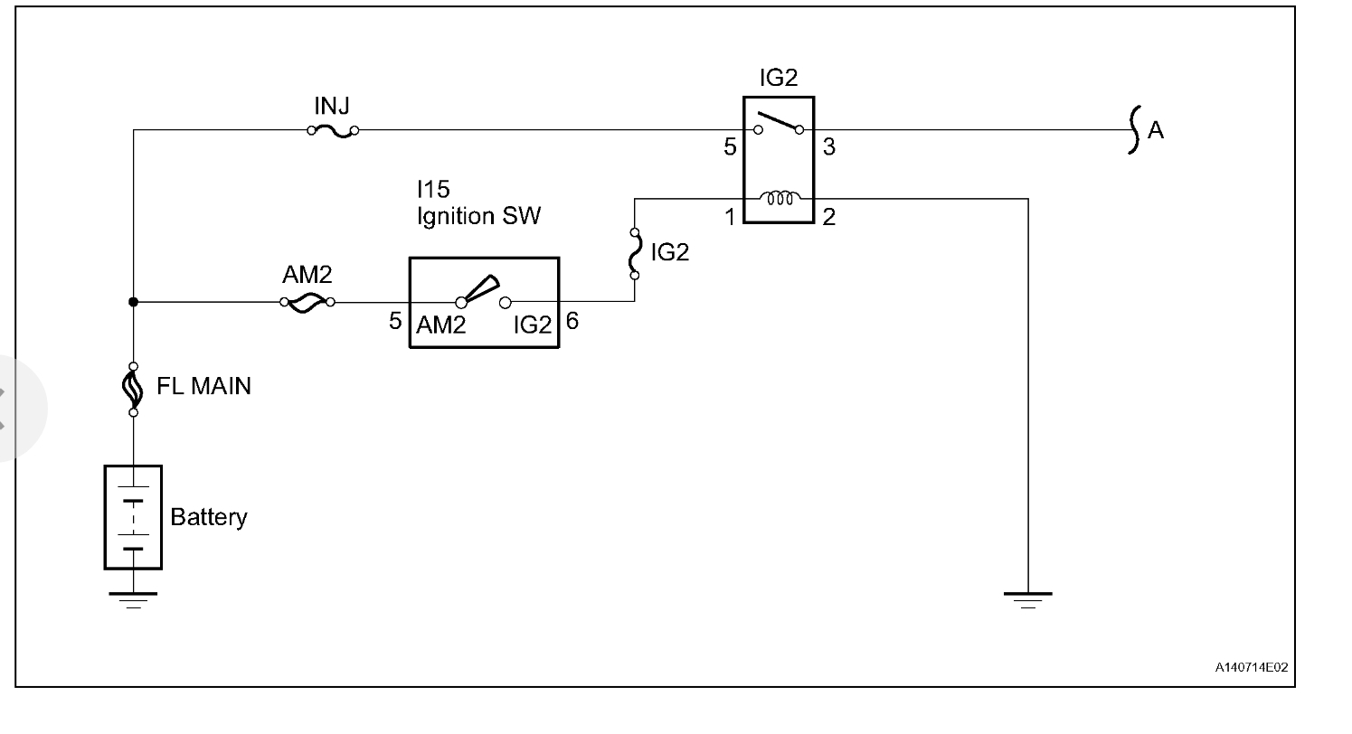

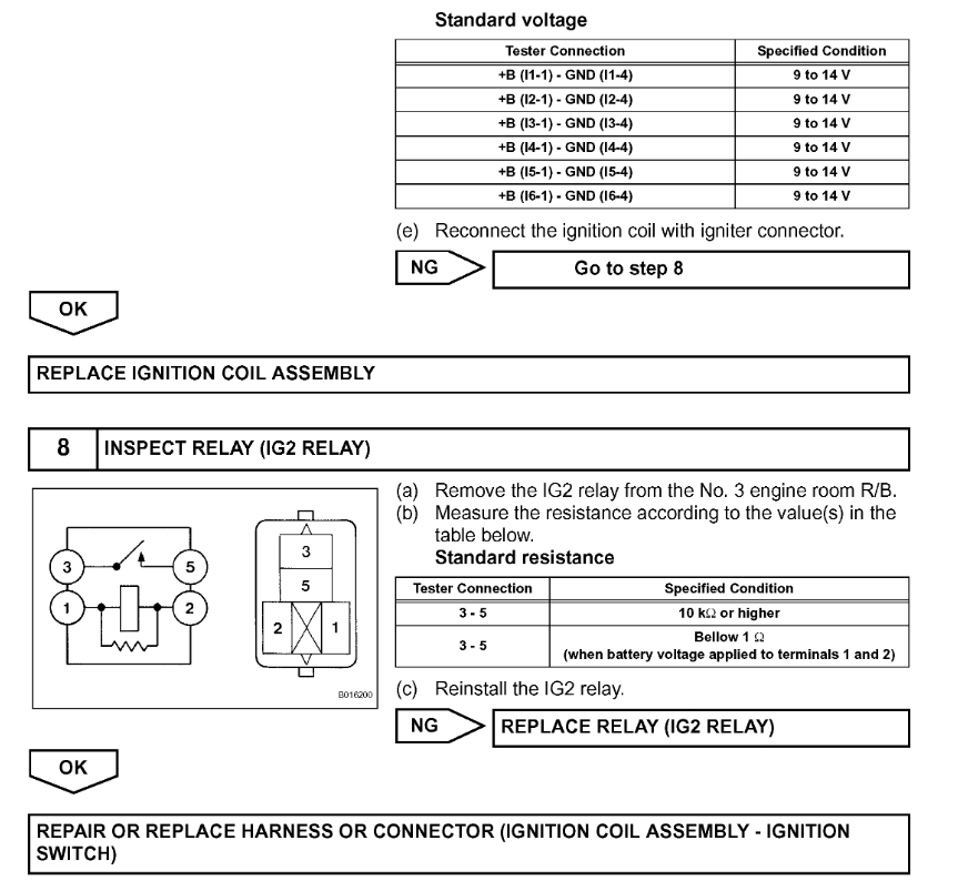

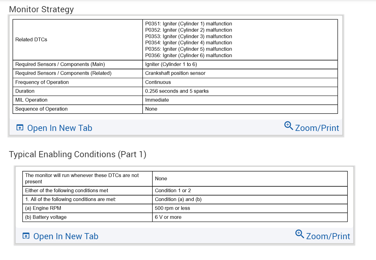

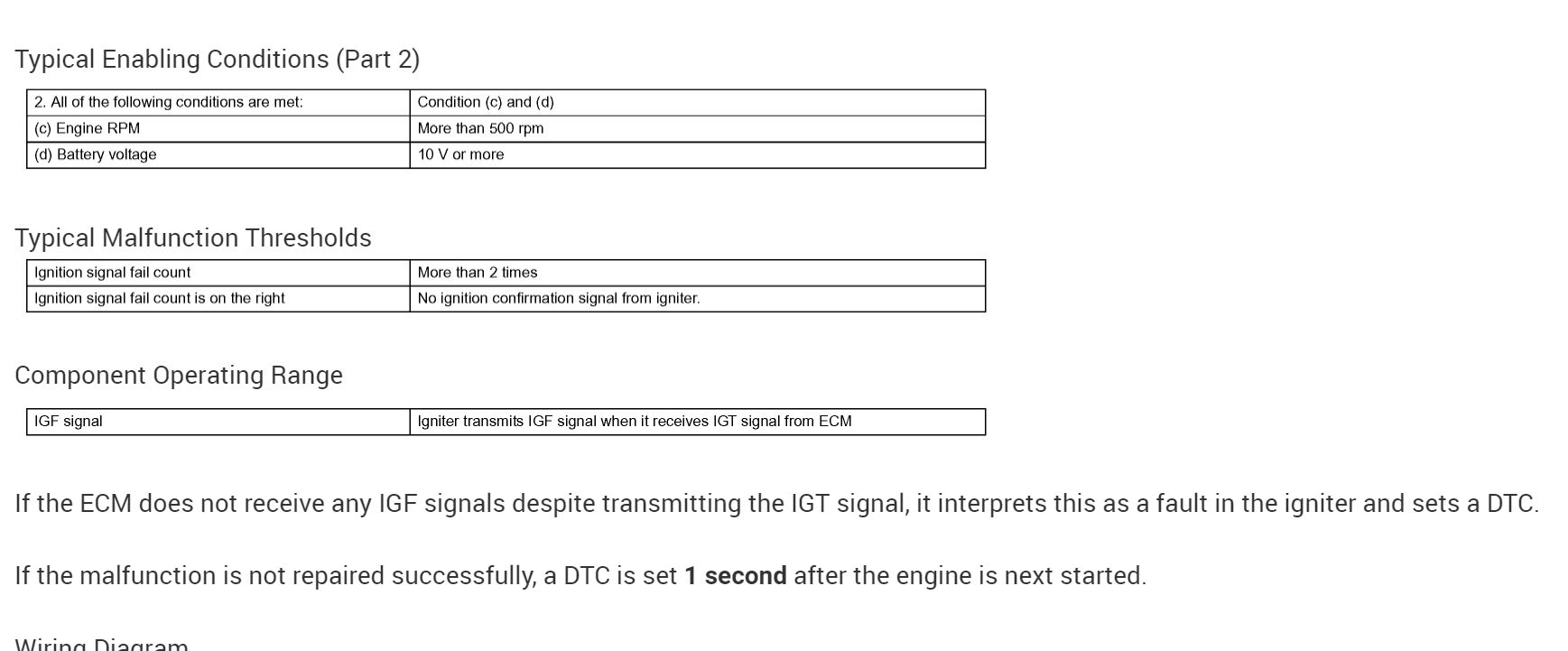

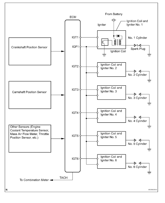

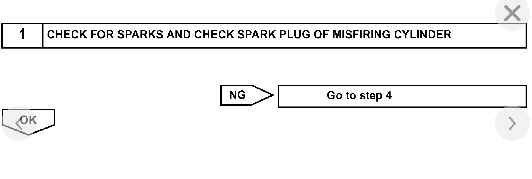

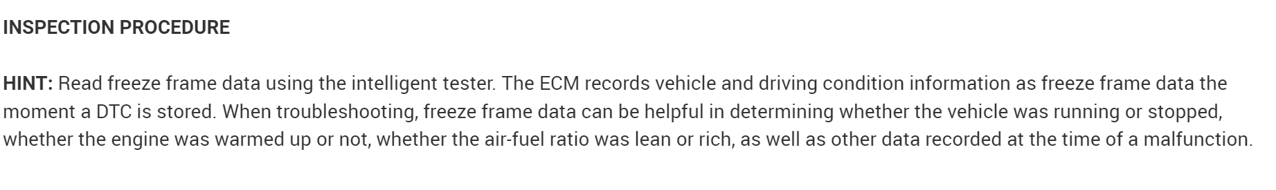

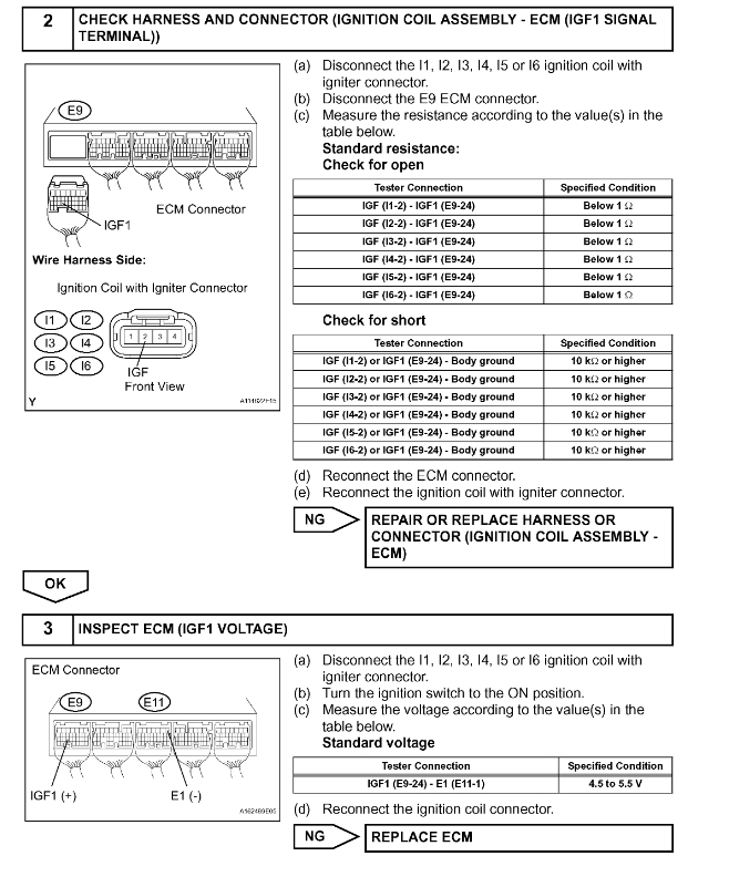

Hello again,

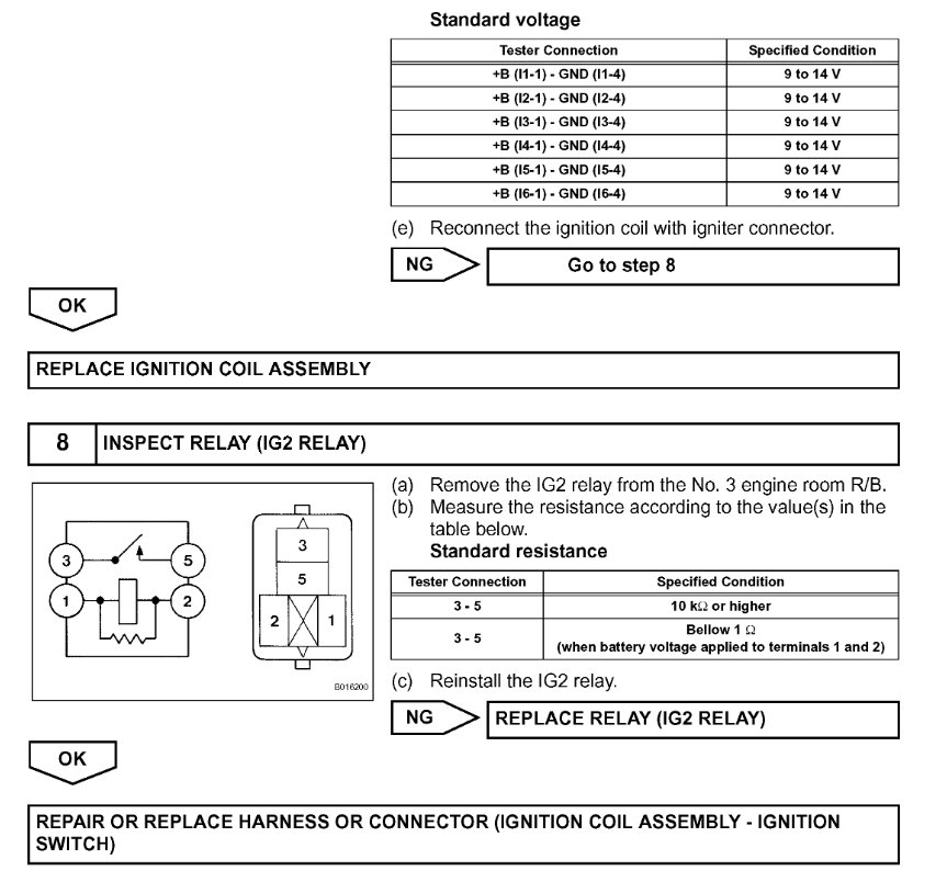

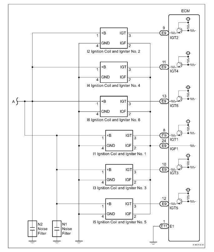

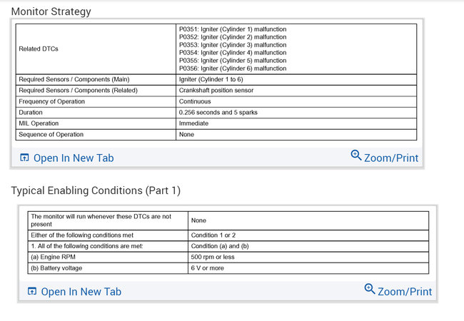

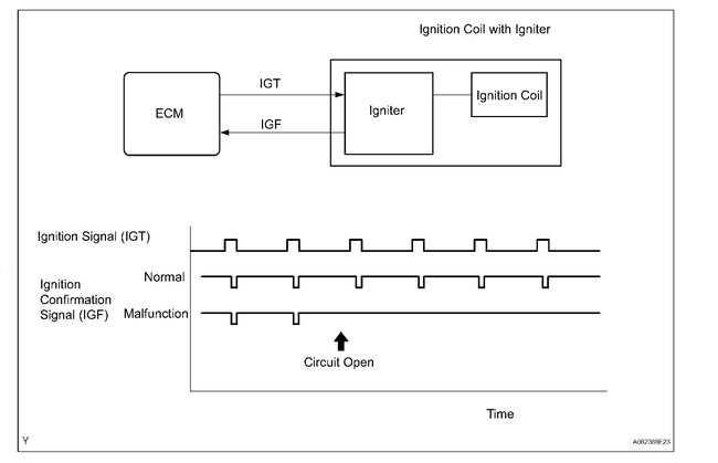

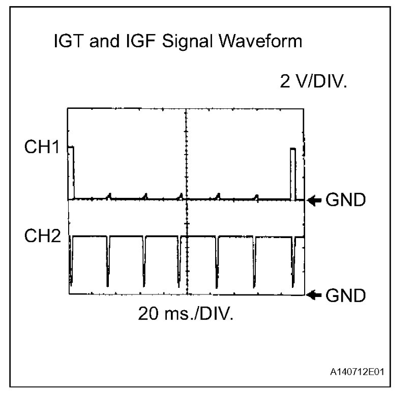

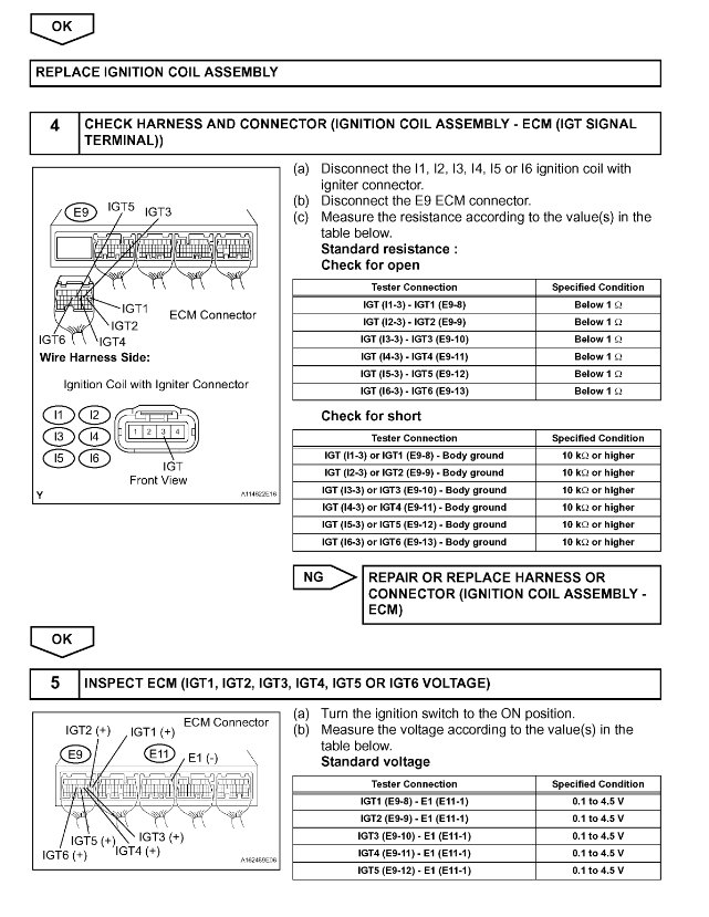

Okay, I have included in the diagrams below a troubleshooting flowchart for your vehicles DTC's. I have also included a link for you on how to use a multimeter below. Go through these and get back to us with what you find out.
Thanks,
Alex
