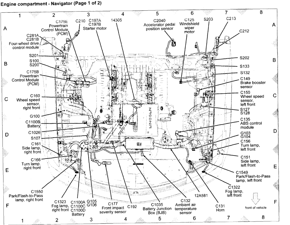

  • 55,214 POSTS
If the sensor is good and the wiring has been checked it sounds like the PCM is the problem. I have seen where camshaft codes are caused by timing chain issues by not the crankshaft sensor.
Here is the location of the PCM you can try a used one but chances are you will need to have it programmed must shops can do it for $130.00.
