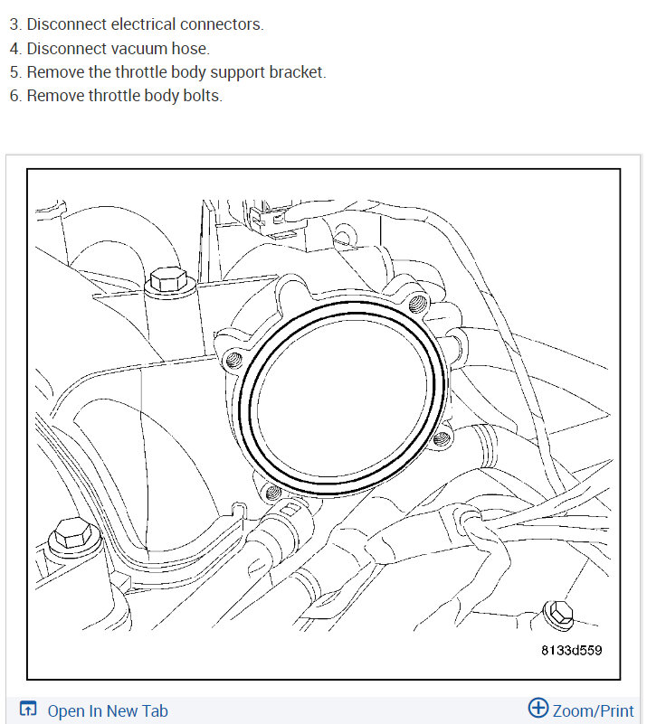

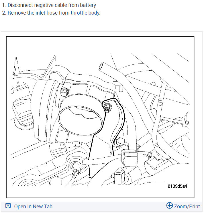

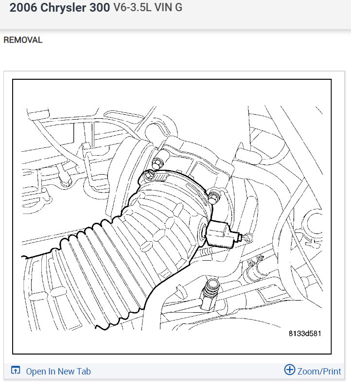

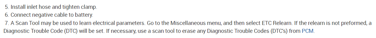

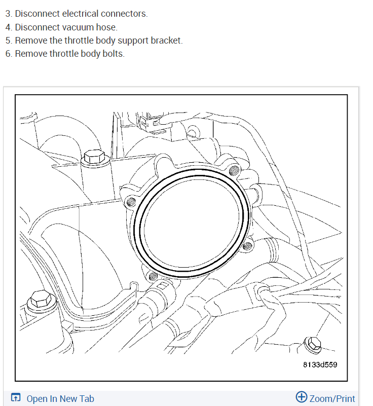

This sounds like a classic throttle bore or accelerator pedal sensor going out, but we have had good luck fixing this issue by cleaning the throttle body. Here is a generic guide to help you step by step with instructions in the diagrams below to show you how on your car:
If this doesn't help, we should scan the PCM for codes.
Please read the guides fully before beginning. Check out the images (below). Please upload pictures or videos in your response to the problem so we can see what's going on.
