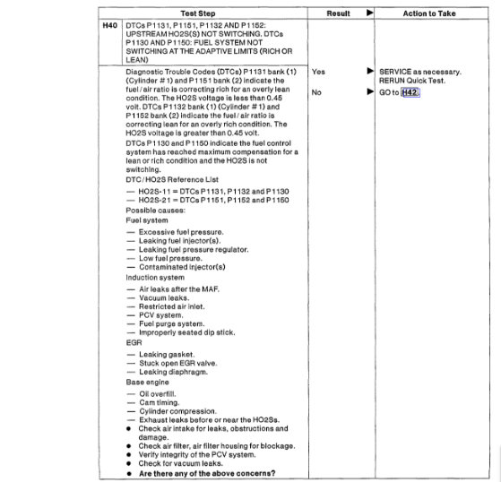

P1151 lack of h025s-21, h02s signal low input.
P0161 ho2s-22 bank 2 sensor 2 heater circuit malfunction.

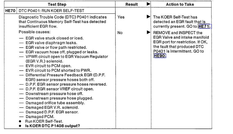

P0401 insufficient EGR flow detected.

  • CAR REPAIR CONTRIBUTOR
the 401 is common for the delta pressure sensor.
Chart below.

Okay.
1151 chart and possibilities below.
Apr 9, 2018 at 9:23 AM
THIN MAN
That may be correct, but I have heard that because of the 02 sensor showing, that is what causes the EGR error.
The 401 code, yes.
