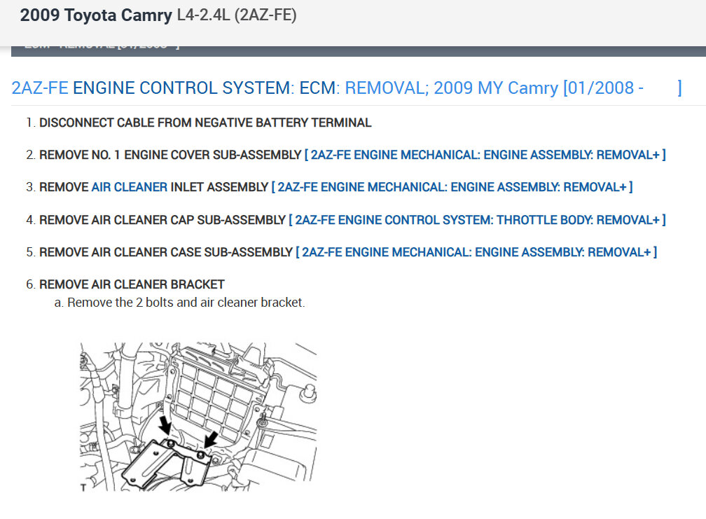

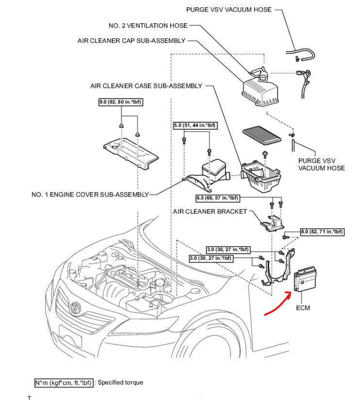

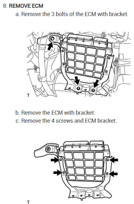

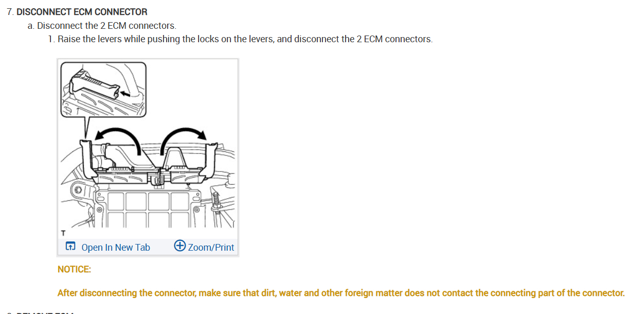

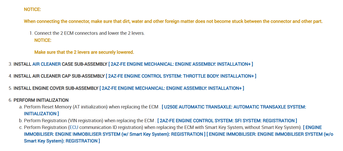

This sounds like the PCM needs to be replaced, you can get a preprogrammed unit by searching Google or Ebay.
P0606 - ECM/PCM Processor Fault: This code points to an issue within the ECM itself
P0137 - O2 Sensor Circuit Low Voltage (Bank 1, Sensor 2): This code relates to the oxygen sensor after the catalytic converter
Here is the location of the PCM and how to replace it correctly. Check out the images (below). Please let us know what happens.

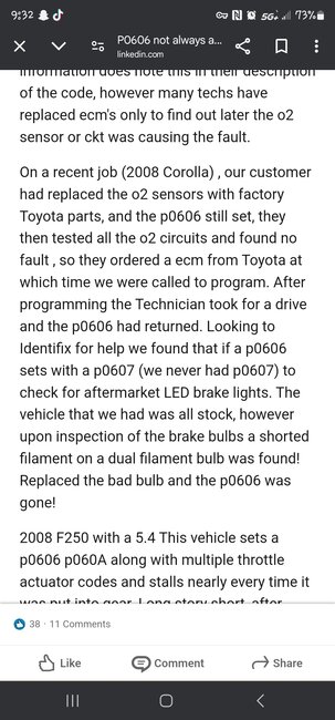

Hey ya'll! Thank you for the answers! I haven't done anything just yet. I live paycheck to paycheck with a family of 4 lol. Moneys a little tight. When I did my research, I read that a shorted filament on a break light was causing this code, on a 08 corolla. I'll add the screenshot i have. Should I go through and check all of that as well? The car has an aftermarket radio in it that came with the car, could something with that be causing the code? The radio tends to shut off occasionally too. I know this is not what ya'll suggested. I'm just trying everything before I drop a bunch of money!
Oct 29, 2024 at 11:25 PM
  • 55,446 POSTS
I don't see how a bulb being shorted can cause this issue, sorry. But I would cycle through the lighting system to make sure they are all working, if you find a problem let me know. Money is tight right now, hang in there. :)
