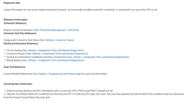

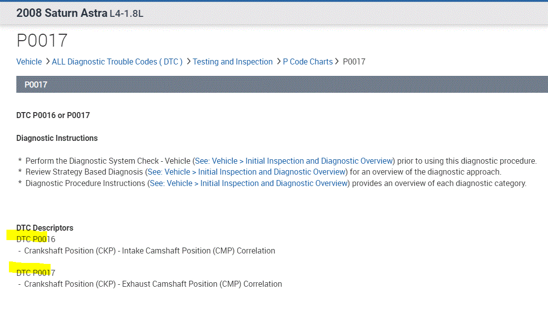

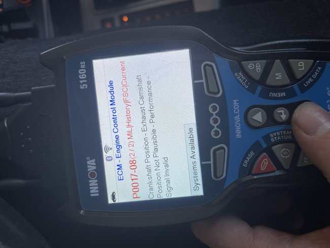

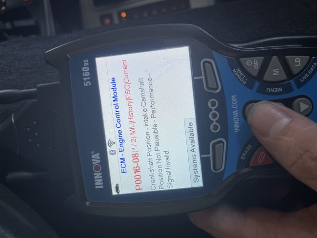

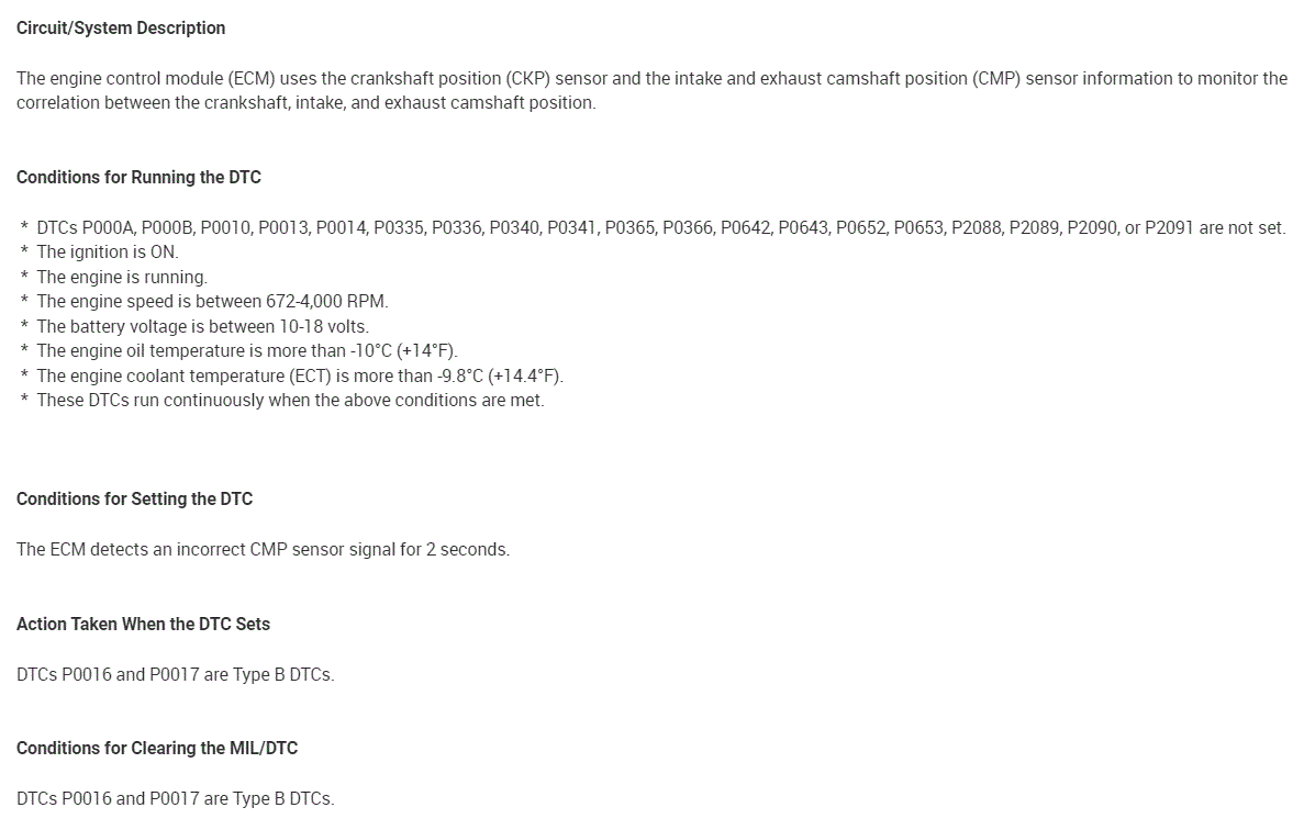

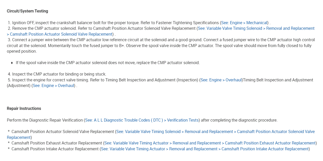

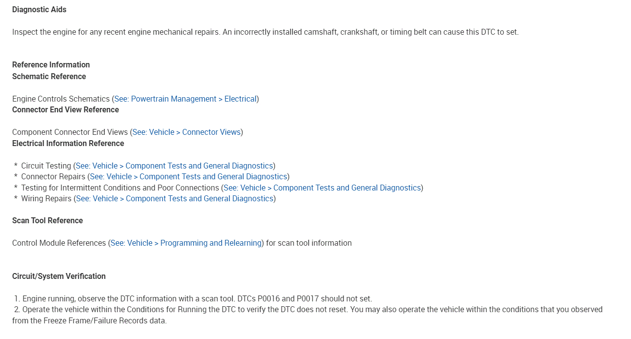

Sorry for the late reply, but these are the other codes it throws up when I was investigating further.
Dec 24, 2021 at 4:42 PM

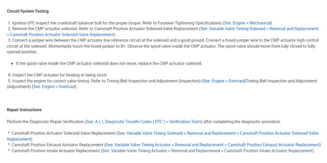

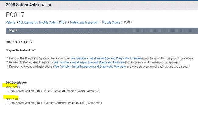

  • 110,241 POSTS
The codes indicate a timing-related issue. The timing between the crankshaft and camshafts is off.
Now, that can be the result of a faulty camshaft position actuator valve, a timing belt that has jumped time, or even stretched timing belt.
Has the timing belt ever been replaced? When it is running, does it seem to have normal power and run smoothly?
If you look below, I attached the diagnostics and descriptions of these codes. Note: they are both listed together.
Dec 25, 2021 at 12:13 PM

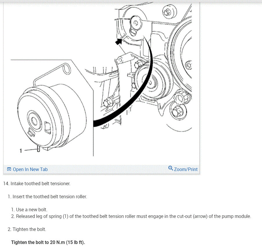

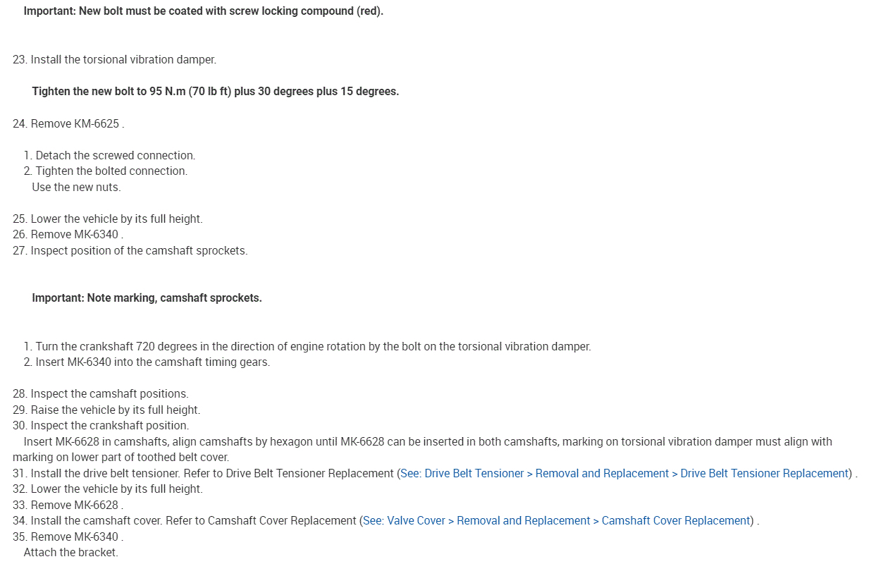

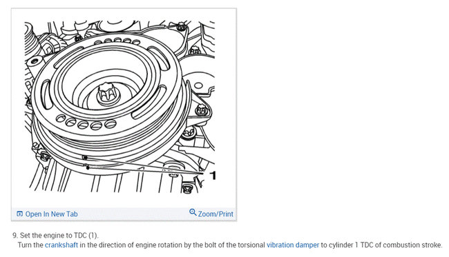

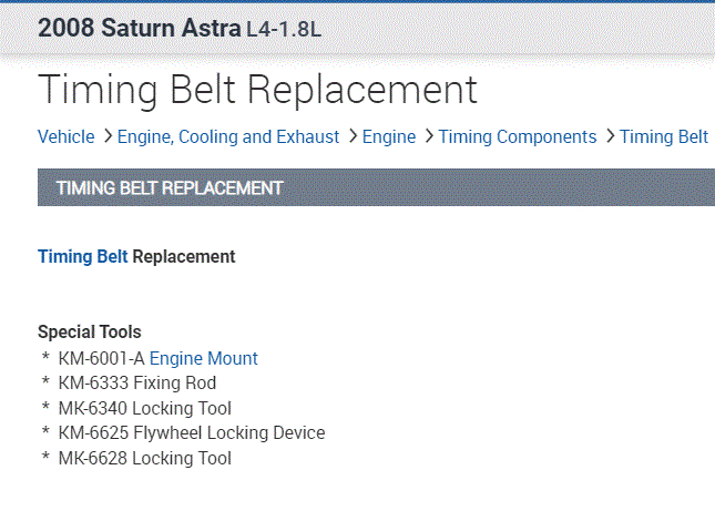

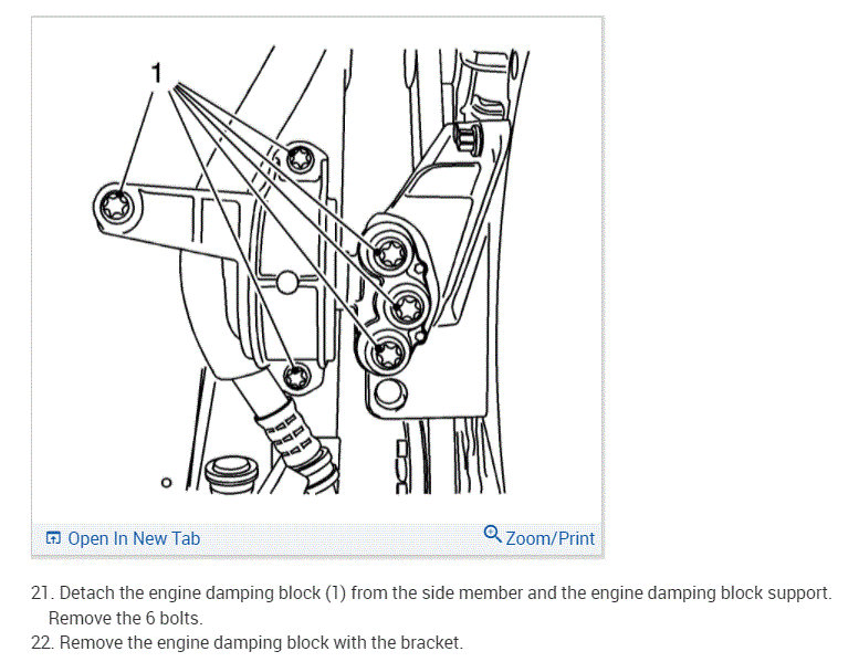

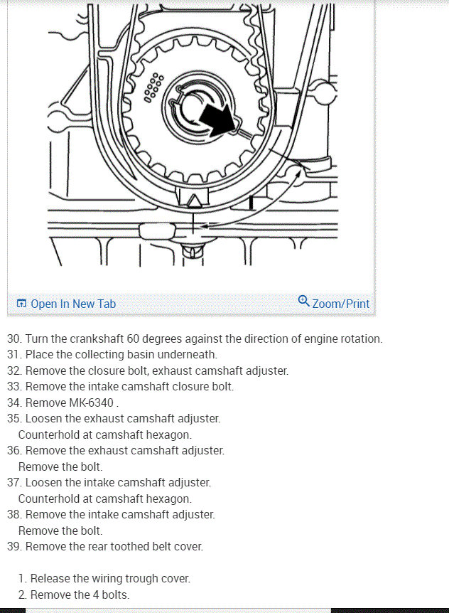

ASTRA27
  • 5 POSTS

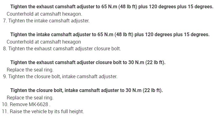

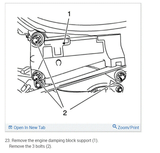

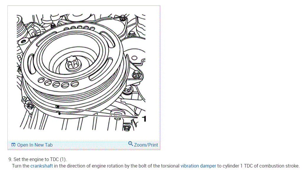

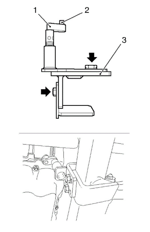

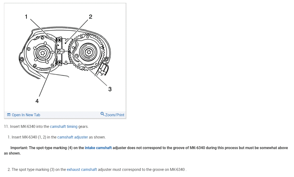

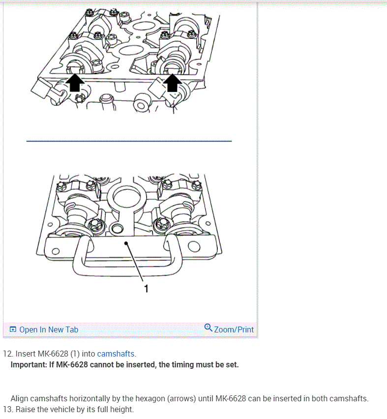

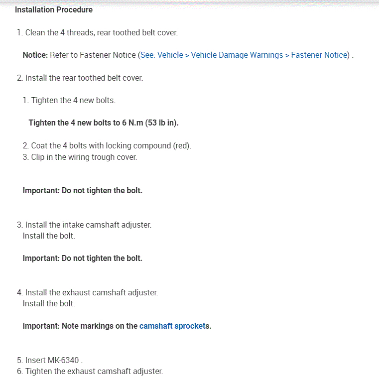

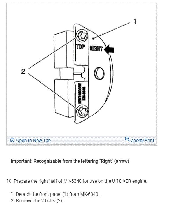

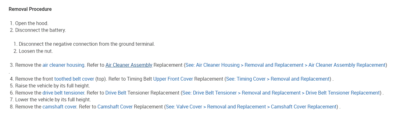

So, the car feels like it wants to go but I have to push on the pedal twice for it to go faster but I don’t know. I don’t know if the timing belt has been changed but I’m thinking more than likely not. I recently got ahold of a mechanic to see if he knows anything about it. He told me it might be the timing belt and he mentioned that if I replaced the timing belt it’s better to replace the water pump also instead of dealing with it later.
Feb 19, 2022 at 3:58 AM

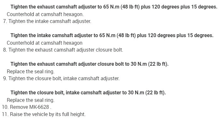

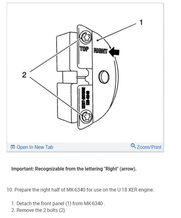

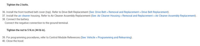

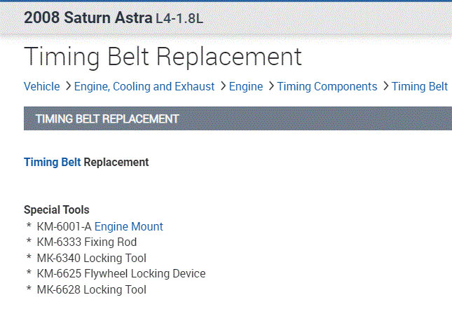

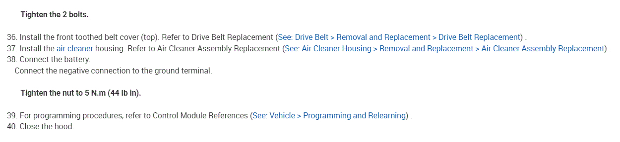

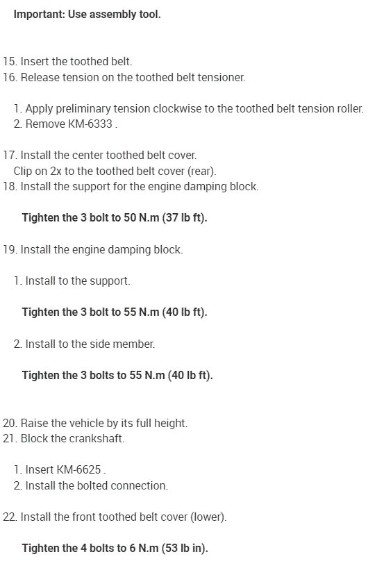

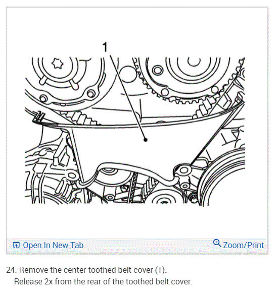

  • 110,241 POSTS

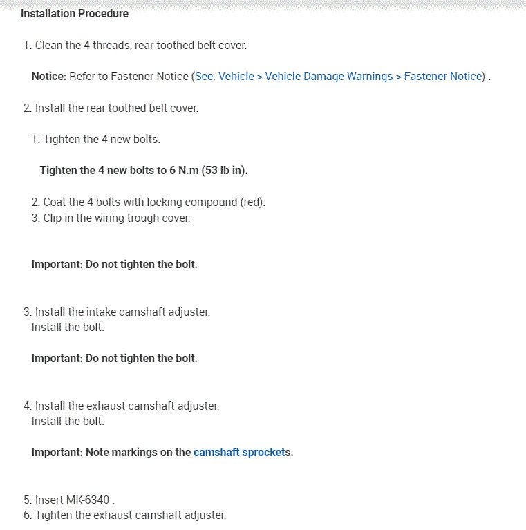

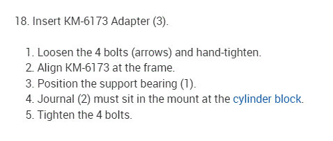

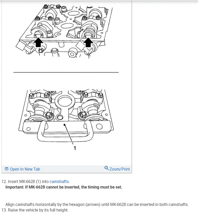

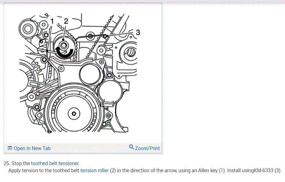

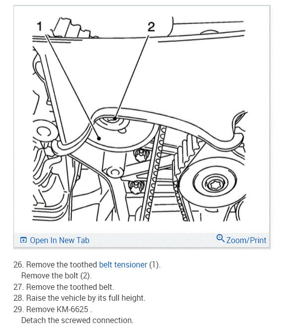

It is very possible that the belt has stretched, or even jumped. If it has never been replaced, that is a good idea to at least have it inspected.
The idea that the water pump should be done at the same time makes sense as well. If you don't replace it and it fails, you will have to basically pay the same for labor to replace the pump by itself as you did for the entire belt procedure.

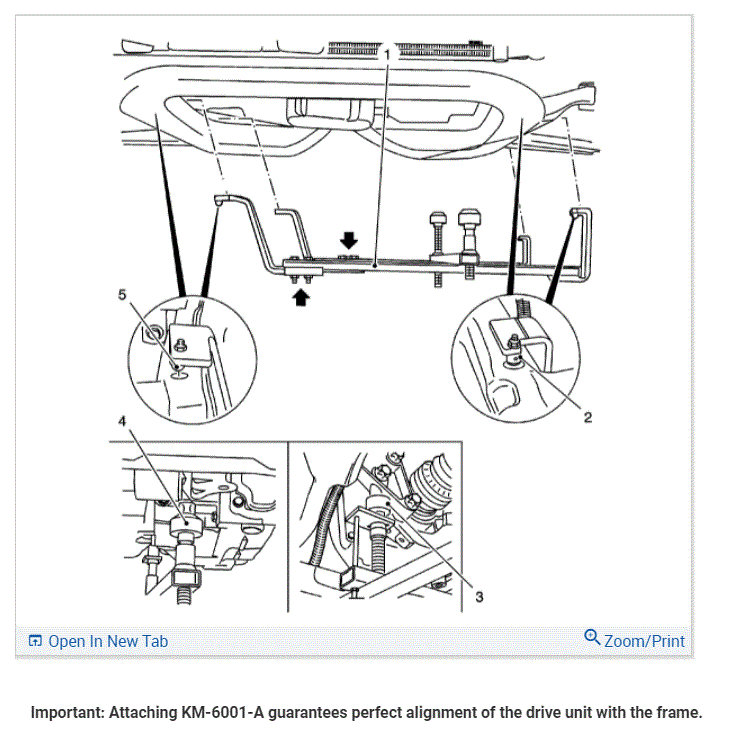

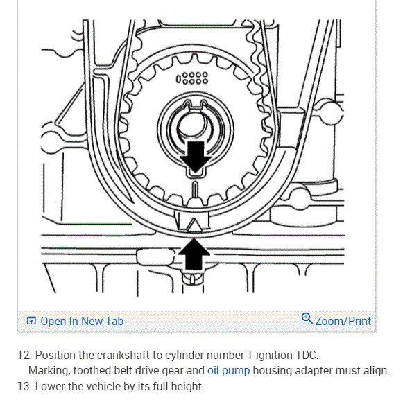

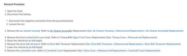

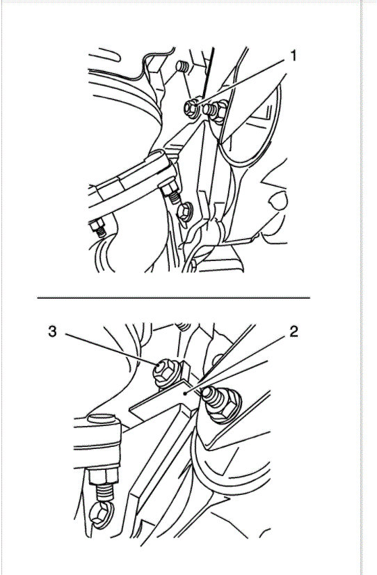

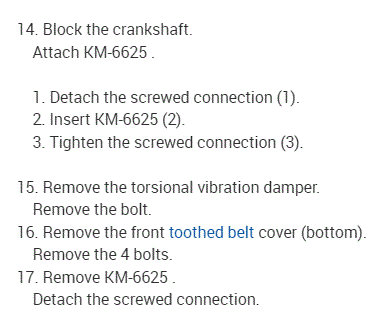

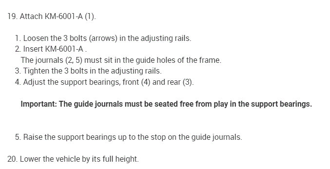

If you plan to do it yourself, I attached the directions below.
Feb 19, 2022 at 5:09 AM
