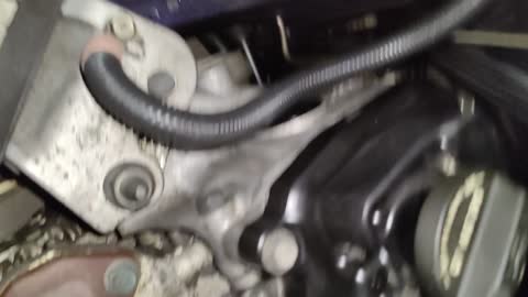

Yesterday my check engine light went on, I immediately used a reader, and it is throwing the dreaded p0420. There are absolutely no performance issues whatsoever.
However, a couple days ago I decided to change my oil. I had just driven the car, so I had to wait for it to cool down a bit before I got under it. That is when I noticed a hissing sound under the car somewhere. I thought maybe it was the A/C and didn't think anything of it (not sure why because I've never noticed this before).
I also decided to clean the engine department under the hood on this day with some degreaser and water followed by a bit of tire foam. Not sure if this impacted anything.
What should I do?

Also, the hissing goes on a long time after I turn the engine off, at least 15 minutes you can still be heard when I pop the hood. You can't hear it without the hood pops and certainly not from inside the car though.
Apr 6, 2022 at 1:20 AM
  • 110,194 POSTS
That is odd. Do you hear it for 15 minutes only from under the hood? I wouldn't think that would be the exhaust. Is it loud enough for you to record and upload it for me to hear?

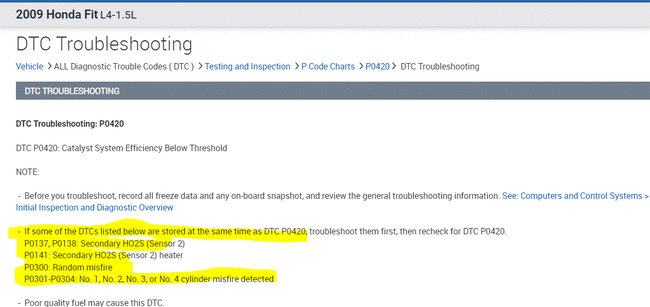

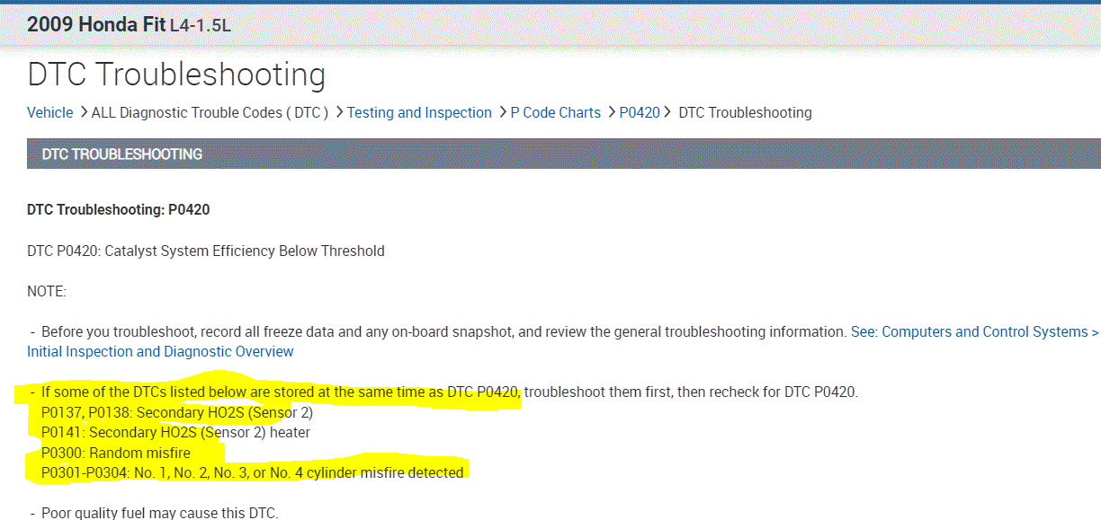

As far as the code is concerned, is the P0420 the only one stored? I ask because there are other things that can set it. See pic below.
If there aren't other codes, then it is likely the converter needs replaced.
Let me know if you can record it and if any of the codes listed below are stored.

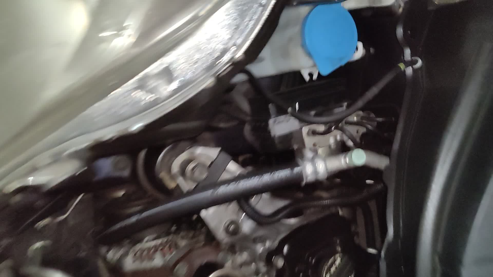

Here I drove 1.5 miles and lifted the hood and heard nothing. Then I drove it back home with A/C on full blast and lifted the hood and the sound was back. Not sure if A/C had anything to do with it or it just needed to be driven more.

Also, I am only getting p0420 code. Today I purchased a bottle of duralube, erased the code from reader, put half of it in with 1/4 tank gas, drive around for like 75 miles until tank almost empty, went and put the rest of the bottle in and filled tank of gas, drive around a little more, code hasn't come back yet. No performance issues whatsoever.

I believe what you are hearing is refrigerant gas in the expansion valve. I noticed you didn't hear it when the AC wasn't used, and you did when it was.
Unless you have a leak, the sound is not out of the ordinary. Please understand that it was hard to hear, but that is what I thought I heard. Pay attention to see if it only happens when the A/C is used. If that is the case, there shouldn't be anything to worry about.
Has the check engine light returned? If it hasn't, let's keep our fingers crossed. If it does return, let me know. If no other codes return at the same time, I suspect the converter will need to be replaced.
