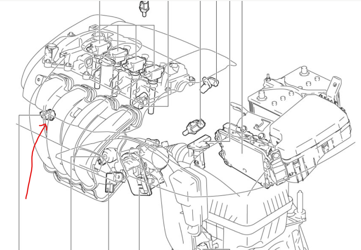

Check engine light came on last week. Car runs fine.
P0192 current, and P1450 pending. Thanks :)
Aug 30, 2024 at 3:21 PM
  • 55,051 POSTS
I would replace the fuel pressure sensor which is common and then clear the codes to see if the pending P1450 code comes back.
P0192 - Fuel Rail Pressure Sensor Circuit Low Input (Current):
Here is the location of the sensor. Check out the images (below). Please let us know what happens.

Thanks. I've got some new additional info. After driving very gently for a few days, the check engine light went out. When I noticed the light went out, I tried accelerating hard. The car started to accelerate, hesitated briefly and then continued to accelerate. At that moment of hesitation, the check engine light came back with the same code. I tried looking at live data from the fuel rail pressure sensor. At warm idle in park, ac off, the readings vary between 2940 and 3080 kpa. Would you still recommend replacing the fuel rail pressure sensor?
Sep 1, 2024 at 4:32 AM
  • 55,051 POSTS
Yes, this can happen if the sensor is having an intermittent problem. I would replace the sensor. There is an outside chance you have a fuel contamination problem.

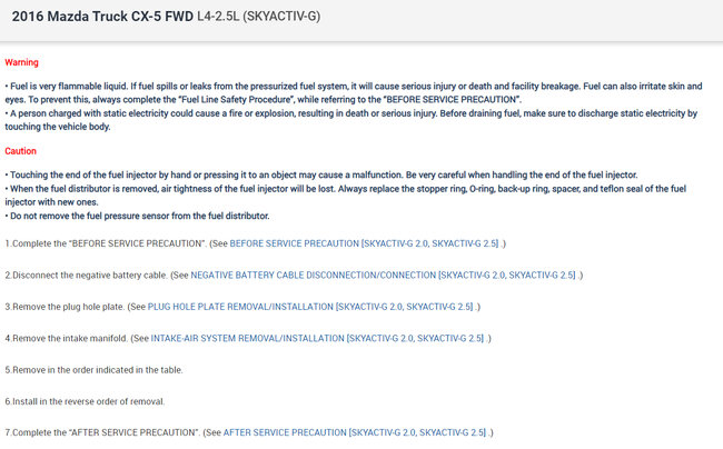

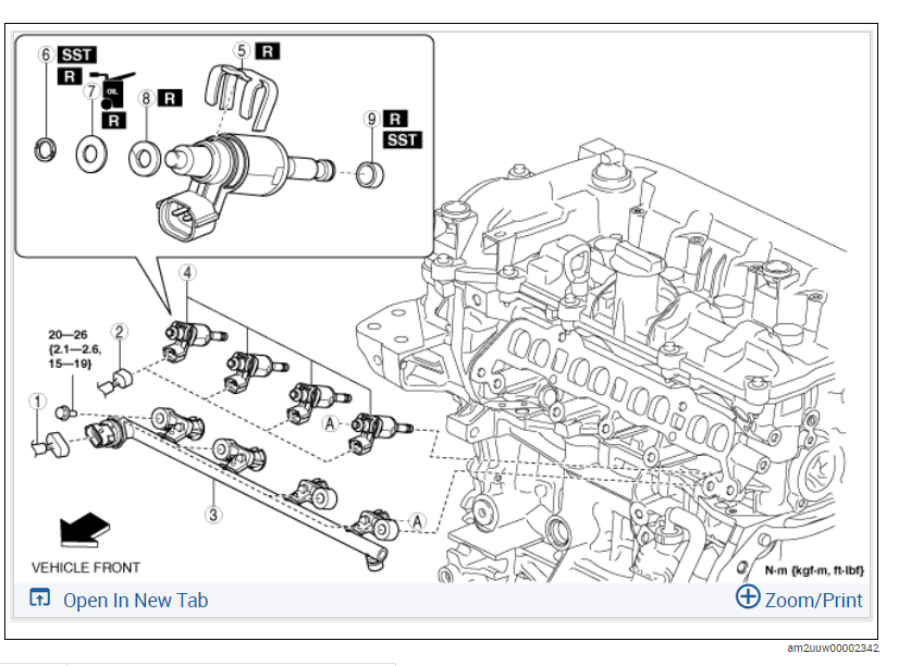

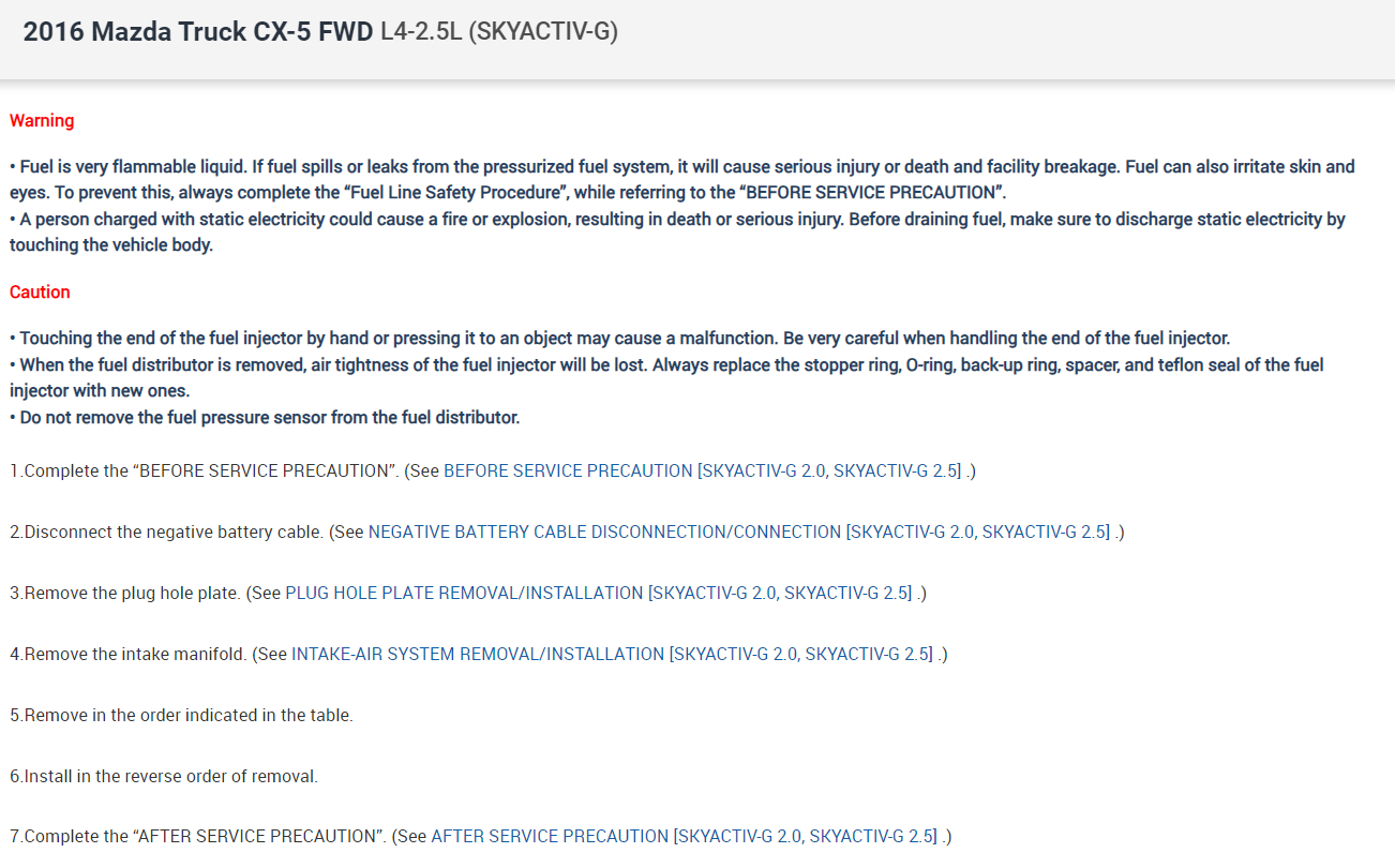

Looking and looking for this sensor. Can't find a part number. Could it be, it's only sold with the whole fuel rail on my car? I can see what looks like the correct sensor in images of the entire fuel rail. I noticed in my original post I said 2016, but when checking the VIN, I guess mine is a 2015. Maybe that makes a difference? JM3KE2CY9F0478828 Thanks
Sep 1, 2024 at 12:30 PM
  • 55,051 POSTS
Yep, you are correct:
The fuel pressure sensor cannot be removed as a single unit. When replacing the fuel pressure sensor, replace it together with the fuel distributor as a single unit.
Sep 2, 2024 at 3:45 AM
