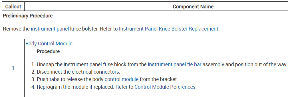

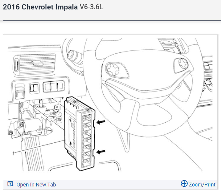

Here is the location of the BCM so you can swap it out for a rebuilt unit that can be preprogrammed if you search Ebay or Google you can find one. Check out the images (below). Please let us know what happens.
