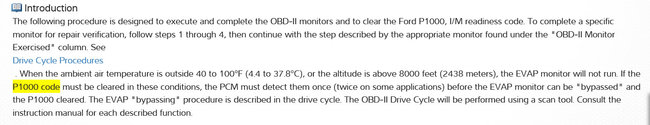

The scanner at O'Rielly showed a P1000.

see picture for explanation, but because of this code a local professional may have to fix this with his professional grade scanner in mode 6 to correct it. you can try driving about five miles on eway at 55-65 mph then floor it a couple times then let it decerate on its own, turn around and come back to where you started may make it go out. If the car was just inspected it was set up wrong for inspection like federal vs California etc. may have caused this as well. picture comes on next email.

Thank you for the quick replies! I took it out on the highway for twenty minutes and the light did not clear. I attempted to clear the P1000 code using the parts store's Bosch scanner. The staff said he didn't know what mode 6 was.
We do not have inspections in my part of Wisconsin (not sure about the MSP/St. Paul area where it was from) so I do not know what or if anything was done regarding that.
Do you have a source from where that image came from?

yes it came form our manual have a mechanic fix this with his scanner then, it is a dive cycle problem and some you cannot get rid of . the auto parts person would not know what mode 6 is because their scanner cannot do it, it is just another tool that mechanics use on their scanner.

Hi again. I got a more advanced scanner and poof that issue is gone but I have another.
