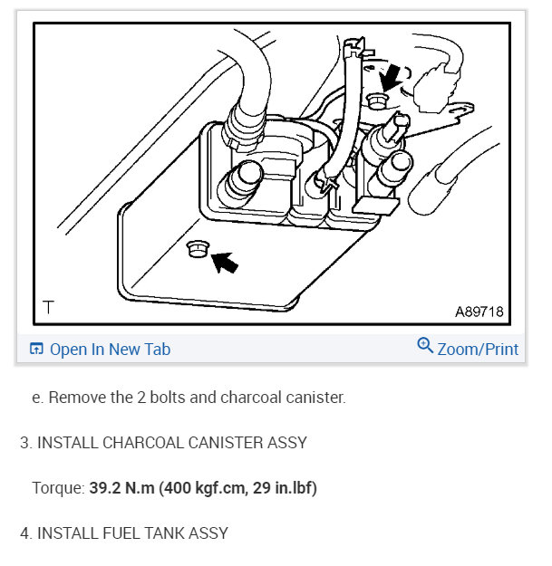

Shop gave me codes p0440, p0441, p0446, said car needs canister, purge valve and fill cap. Quoted $1,625.00 parts and labor. Is the cost reasonable? Is it worth it to even fix? :-(

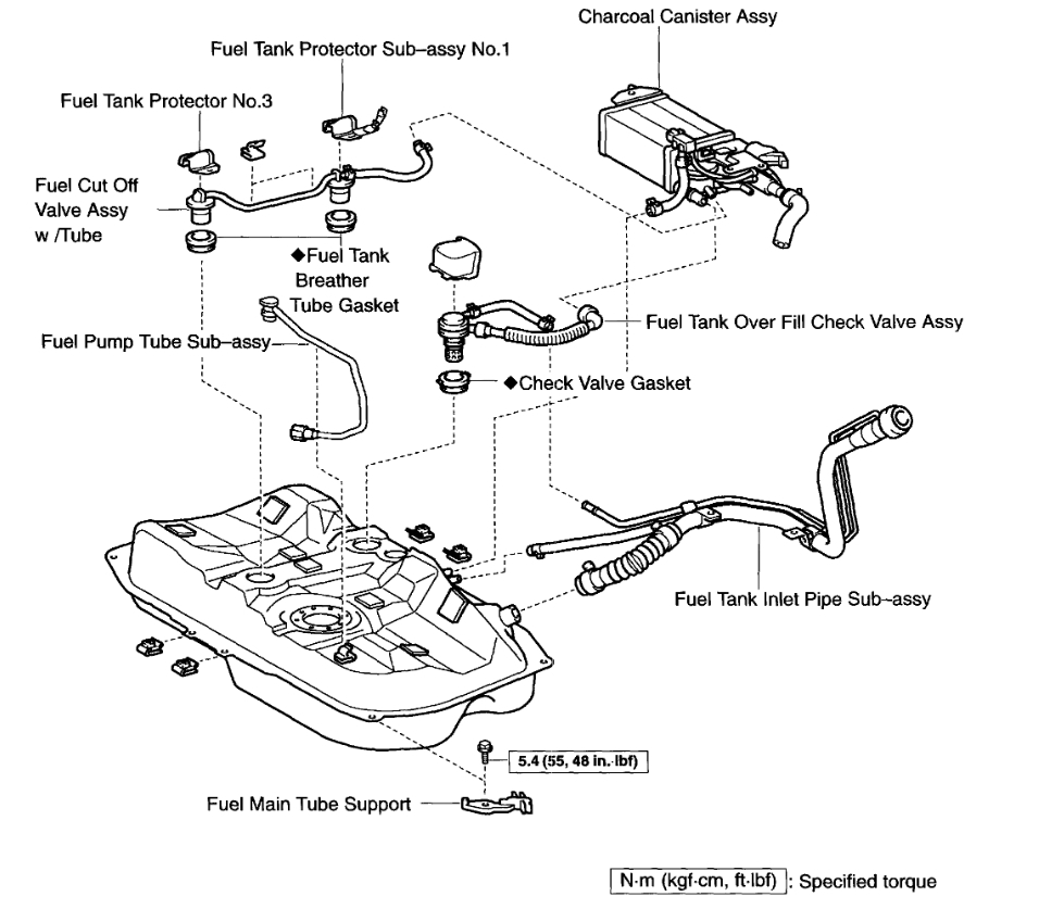

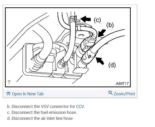

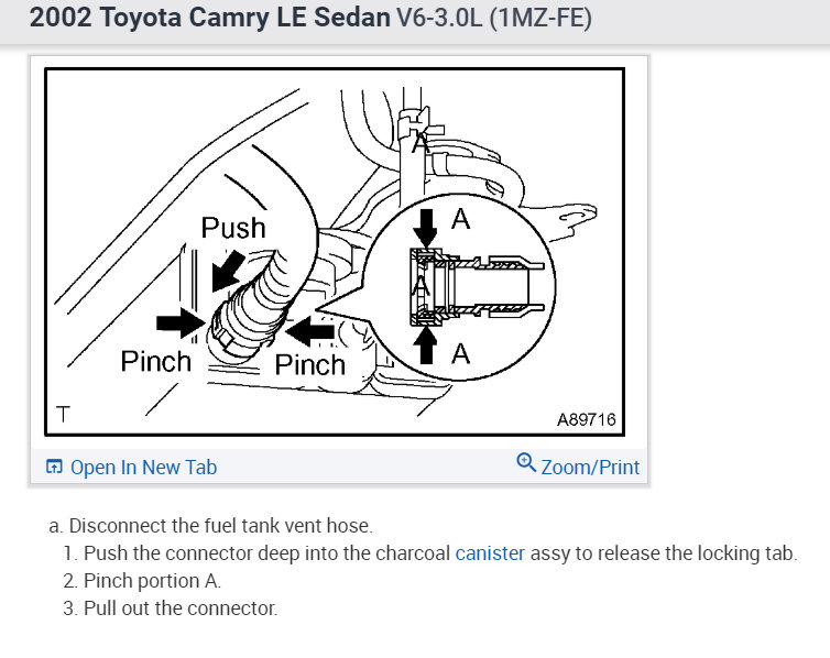

Here is the prices and labor times to do the job and how the job is done in the diagrams below:
Vapor Canister 7774006111 - $381.42
Labor 2.1 HRS
Vacuum Switch Valve 1.1 HRS
