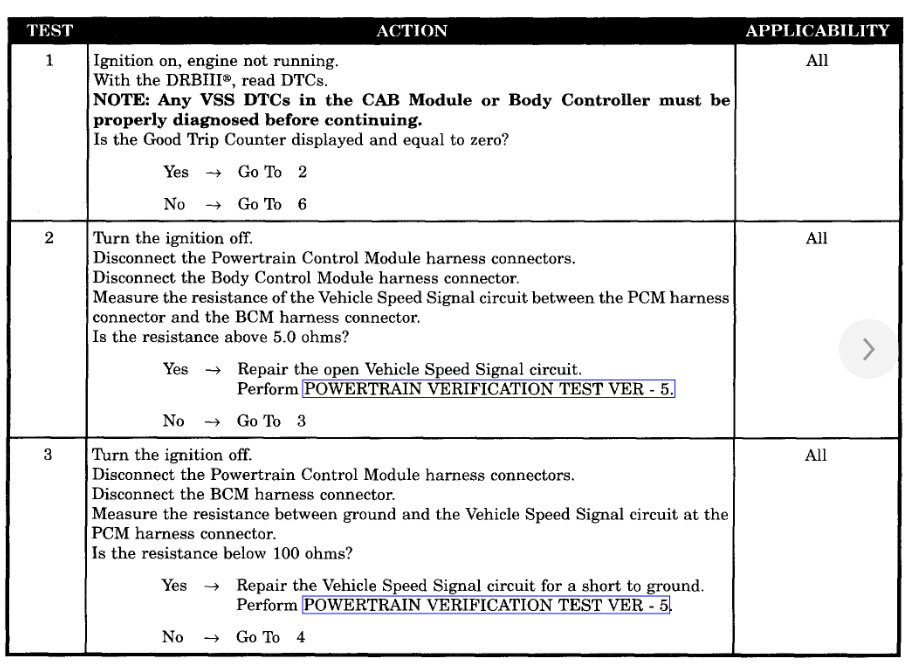

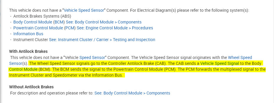

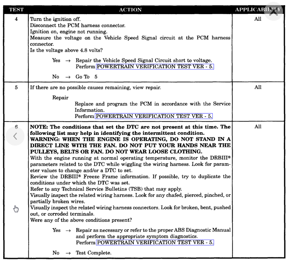

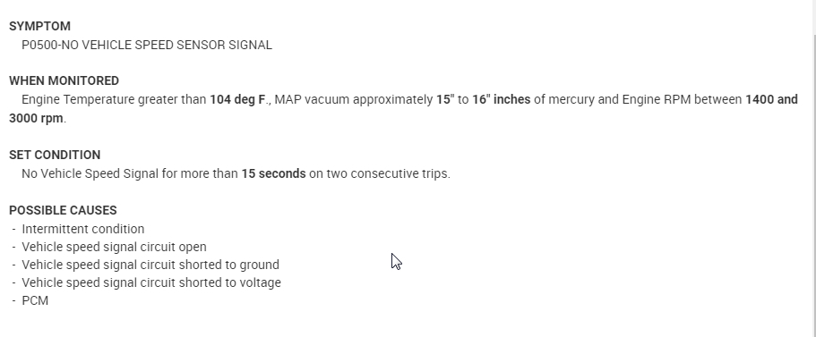

Here is the diag for this code. This is a circuit code so more than likely you have a wiring issue. This test runs through the path the speed signal goes through and has you testing the wiring.
Let me know what you find and we can go from there. Also, if you have questions let me know because I am not sure your level of electrical testing. Thanks
