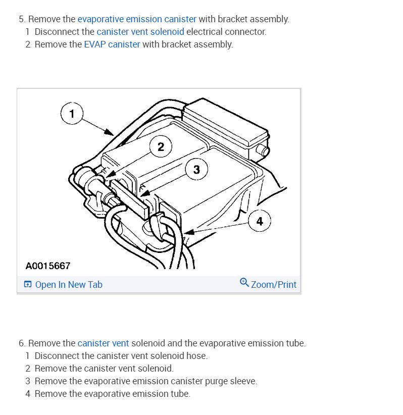

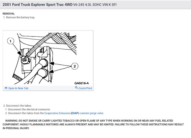

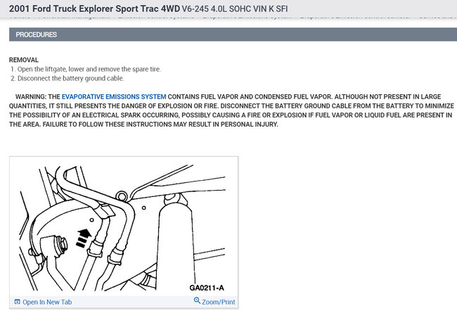

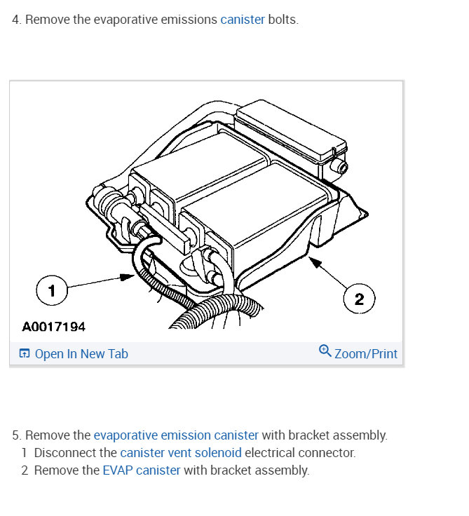

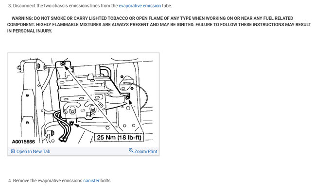

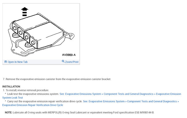

My check engine light came on I took it to AutoZone they said it was an evap leak next the check fuel cap light comes on I replace the gas cap reset the codes by unhooking the battery. Well, a week later the check engine light is back on 3 days later the check gas cap light back on. It drives good gets good gas mileage I don't smell any gas at tank I checked the gas tank clamps there tight I don't know what else to check next.
Jul 9, 2023 at 8:57 AM
  • 55,764 POSTS
So, the EVAP system is a closed system if there are any leaks in any is the lines or the charcoal canister it will have this problem. If the lines are okay, I would swap out the purge solenoid and then the charcoal canister. Here are the locations for both. Check out the images (below). Please let us know what happens.
